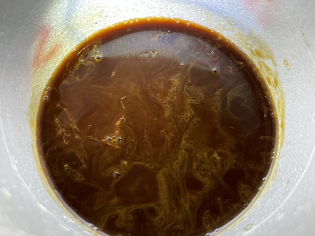

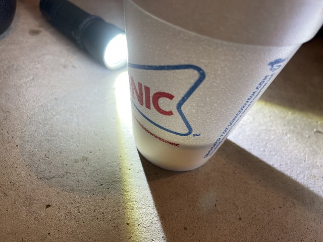

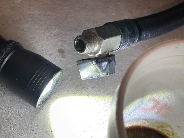

I have the UPR full catch can with a remote drain line so after 3,000 miles it was mostly water with a skiff of oil on top. Small Sonic cup of Starbucks Mobile One with dash of Carmel Creme.
