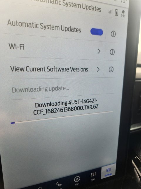

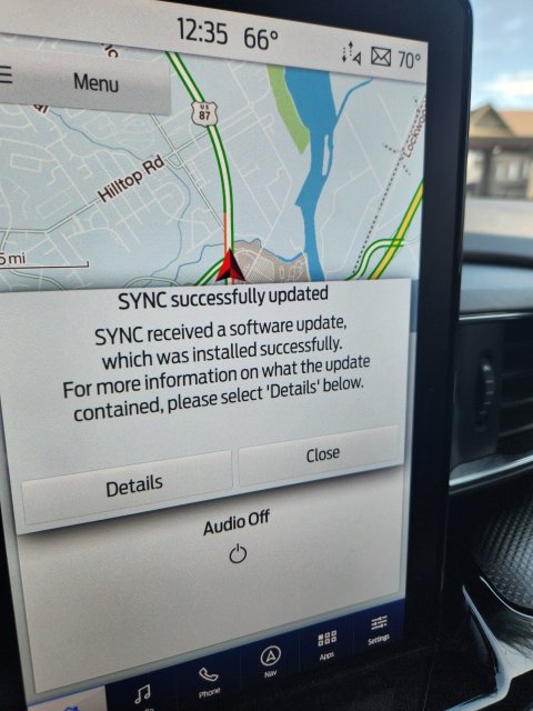

I really didn't have much of an issue until I updated to 23188. Did so through USB. I then received intermittent blackouts of screen, radio silence, front camera inaccessible message on dash, and flashes of "XM subscription updated" message on the top of the screen when it flashes back online. Decided to look at updates available through Sync Menu via WiFi in the onscreen menu and it started to download file. Took about 40minutes or so and let it do it's thing. So far no screen glitching out but on every startup I get a mail icon in top right screen that upon clicking through confirms the SYNC software update of 3.4.23188_PRODUCT that I had already done through USB. So that is nice :confused: 20240314_123642.jpg 20240319_123556.jpg 20240319_123603.jpg 20240319_123813.jpg
