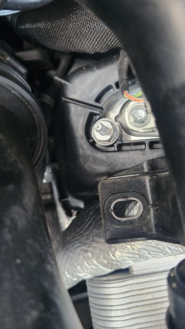

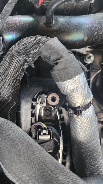

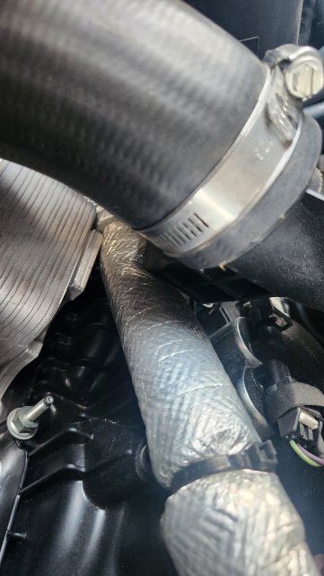

Well, it's not over, unfortunately.
This morning I heard a weird buzzy/plastic vibrating sound in the engine bay when it got started and the kids were loading up in it for church. I didn't get to check on it until this evening, but what I ended up finding was a bunch of busted/missing hold down clips and brackets, a charge pipe hold down bracket on the passenger side loose due to missing nut from the stud, and the wiring bundle on the front passenger side of the engine was routed UNDER that bracket, so it's got a nice crease in it now. I was able to get a bunch of the loose coolant, vacuum lines (both soft and hard), and electric bundles secured with zip ties close to where the busted or missing clips were, but I can't do a thing about the charge pipe bracket that bolts to the passenger side valve cover (or the wiring bundle hold down close to it) since the nuts are missing.
So, it looks like it's going back to the dealer. I told the service manager in an email this evening that the next time I get it back he should plan on spending several minutes with me going over the coolant, vacuum, and electric lines under the hood to ensure everything that I can see is secured and not flopping around like it was. Heck, I found one multi-line bracket broken and 2 of the lines that were supposed to go into just hanging loose which had obviously contacted the coolant lines next to them multiple times. Nothing like sending a vehicle home with a customer that's a time bomb waiting to go off. Apparently "quality is job none" there... So frustrating. It's pretty obvious that whoever pulled the old engine didn't give a rip about busting the brackets and retaining clips, and then whoever put the new engine in didn't care at all either about securing the dozen or so lines that were obviously not secured like they were from the factory. They didn't even attempt to secure them... Not even zip ties.
Charge pipe on passenger side:
Another view of the same charge pipe and just how far it's off (and the wiring bundle it's creasing):
Wiring bundle in the same passenger side valve cover area that's not bolted down:
This is the triple line bracket on the top of the engine that was hanging loose. There's a metal anchor it's supposed to snap into, but they broke off the piece of plastic that snaps in, so I've just got it zip tied around the metal anchor). The middle and right side lines weren't in their clips at all, either. I have never seen a dealership with this level of "we don't give a rip" from the techs... I mean, it's impressive.
Kind of wondering if all the clips and brackets they broke off are going to be parts they have on hand, or if whoever the ticked off tech was who pulled the motor and busted the clips is going to end up costing them a whole bunch of brand new electrical, coolant, and vacuum line assemblies because they can't get the retaining clips any other way. I'm really concerned about that wiring bundle, though... That can't be good for a bunch of 5V canbus lines to get pinched by a sharp plastic bracket every time the engine moves a bit.
