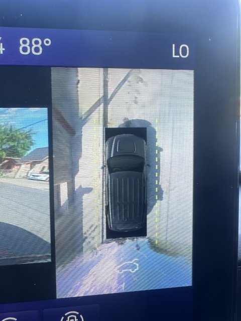

Today I noticed red lines all over the image of the 360 camera system. I went around and cleaned off the lenses and it’s still the same. I can’t find anything on this. And the recall was already performed. I’ve attached an image.

I just see moire effect. This is not all the time, right?

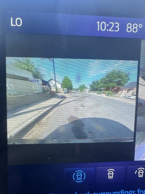

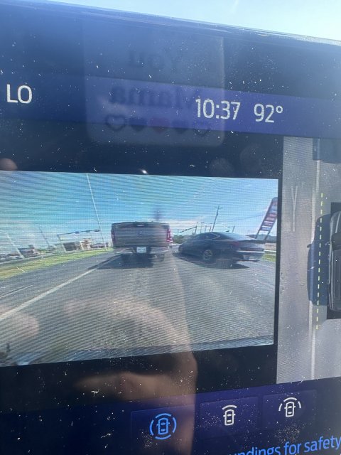

I don’t think it’s the moire effect. I just noticed it for the first time today. If you look at the image again you can see little red lines all around the lower portion of the image. That shows on the screen. The moire effect is from my phone taking the pic against the screen. I’m attaching a small video also.

Brake light reflection on slick surface of tarmac or wet surface?

I dont think so. It was bright and sunny. I doubt the brake lights would reflect that well during the day. Plus the lines appeared on the 360 "bird eye" view also.
On my way home from work tonight the lines were gone. Probably just another weird glitch in afraid.

I had similar effects but mine's were green and had green outlines. Took it in for the recall, havent had any issues since.

Mine has done this maybe 5 times in 40k miles.
Just hard reset the infotainment system fixes it for me.

Hello! Currently having the same issue for the last 5 months. We have a 22 Explorer limited with the big vertical screen. Having issues with the red lines on the camera and Apple CarPlay. What all has been attempted for the fix? They’ve replaced the screen and two other parts associated with the radio. Now we’re waiting for an update for the sync system hoping this will resolve the issue.
