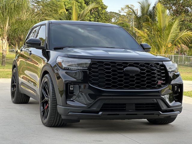

Following this thread.....just got me an Agate 25. Excellent work man! IMG_3463.jpg

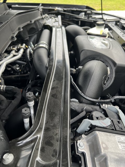

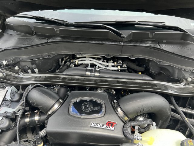

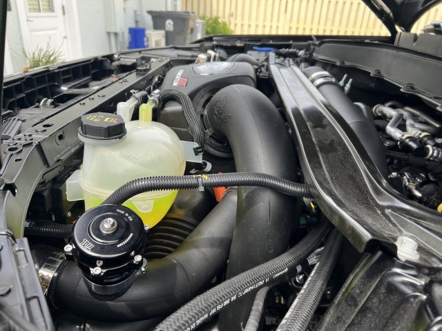

Engine bay pics. Pardon the dust
To work with the aFe intake, Brett made his hotside piping cross OVER the intake manifold. The stock piping runs in-front of the motor and under the intake.
This threw me for a massive loop (ontop of the BOV) as I couldn’t figure out how to route the new pipes. The y-pipe is essentially flipped in directional travel. It wasn’t until I went to his website and looked more carefully at his installed pics that I figured out the new routes
He did a phenomenal job running it right behind the strutbar. It doesn’t touch anything. The aFe driver’s side intake and cold side pipe come awfully close to touching.
Ran the car pretty hard on my way to Tampa today. All highway pulls 50-90 or so. No boost leaks, no CEL.
BBK on order. Gotta fill up the bigger wheels and more brake exposure

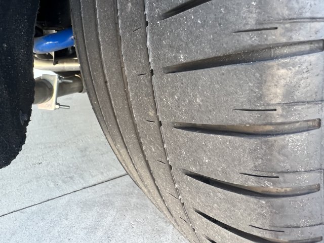

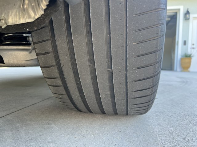

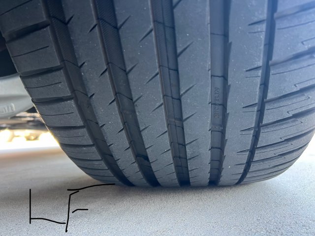

This is a reminder to everyone to get their car aligned ASAP after installing lower springs. I dropped the subframe, but on reinstall, you can see how the thrust angle and rear toe were way off. This has practically destroyed my rear tires.
This is after about 500mi
See below pics. The thrust angle and toe had the rear dragging across the ground. The car was barely controllable changing lanes.
i don’t have the camber I want, so I’m considering camber bolts or even control arms
View attachment 28238 View attachment 28239 View attachment 28240
How about the Oil fill? Is there room, it looks really tight from these pics.
Just have to work around the strut bar, but that's easy to remove

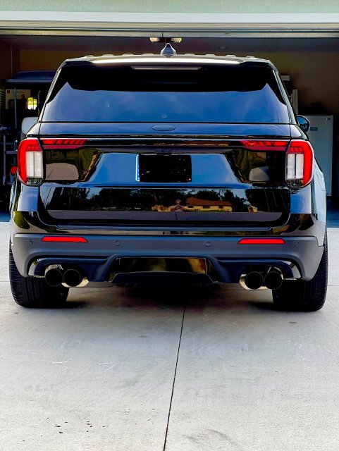

Despite reinstalling the stock exhaust, but with a Gibson muffler, the wife says it is still too loud.
I ordered some Siless 2mm sound barrier from Amazon. A neighbor put it in his Foxbody and it made a huge difference
I hope this works. I do NOT want to reinstall the hideous stock exhaust
I’ll head to a friend’s shop in Tampa in a couple of weeks to pull the interior and install it. He owns a wrap shop and has guys who solely pull interiors

Did you install the Gibson axle back or a random Gibson muffler? I went the Gibson axle back route thinking I didn't want the wife and kids complaining.... Can you believe she had the nerve to say it was NOT loud enough?! I can barely hear it inside the cabin. I should have gone the Thermal route!

I did the axle back. I kept the stock mufflers just in-case. I’m praying the sound deadening is the answer

She says it’s loud. Our definition of loud is clearly different. That being said, the Gibson is about 7dBa quieter than the Thermal at 60mph. Logged both on my phone’s dBa meter.
Is it 100% accurate? That I can’t sayut it’s the same equipment used for both tests
The noise above 80mph is mosty wind, so peak sound is likely that, not the exhaust
I did a screen record, but I can’t post the vids
The toe was likely the main cause of the tire scrubbing. 2.5 degrees in camber is too much but would not do that to your tires that quickly and the wear looks toe related. Did you get this resolved?
