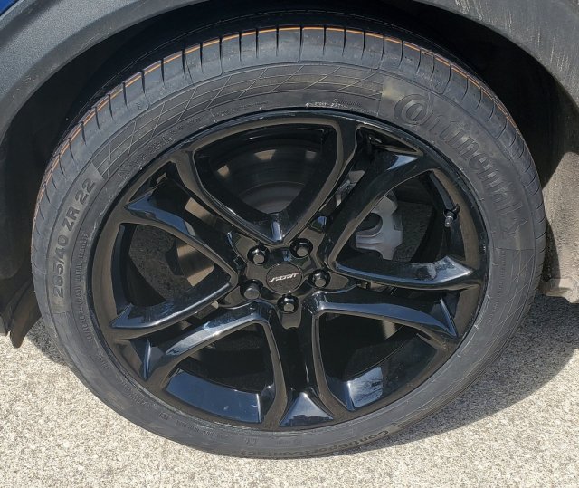

You don't need a 10.5 wide wheel to run a 285, you can go with a 22x9 they are cheaper. I had the factory 20's on my 21 and I ran a 285/40/22 continental on 22x9's for summer use. They fit perfectly like the wheel was made for a 285 tire, small bulge but not too much. 20220420_152600.jpg 20220420_152445.jpg

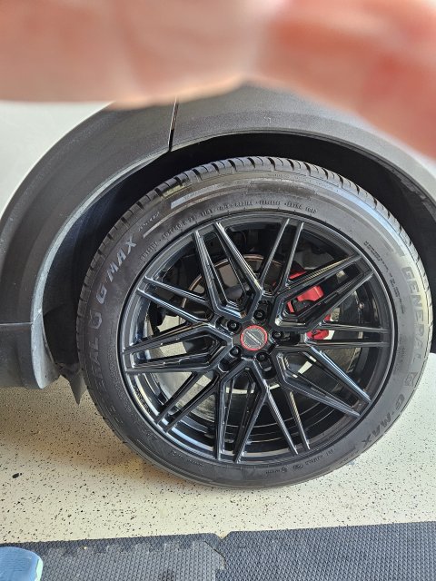

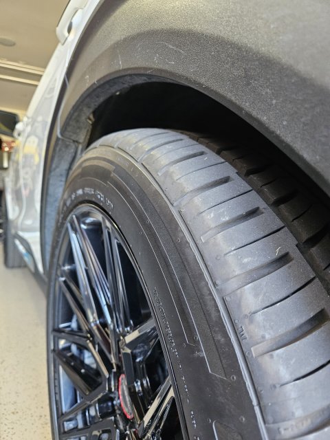

22x10.5 +32 offset. Tires are P-zero 305/40. Not lowered, yet. No rub and as you can see the best wheel on this forum.

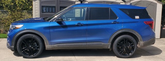

Im running 305/40/22 lowered on Steeda with no issues.. H&Rs do sit lower in the back so not sure. just my two cents.

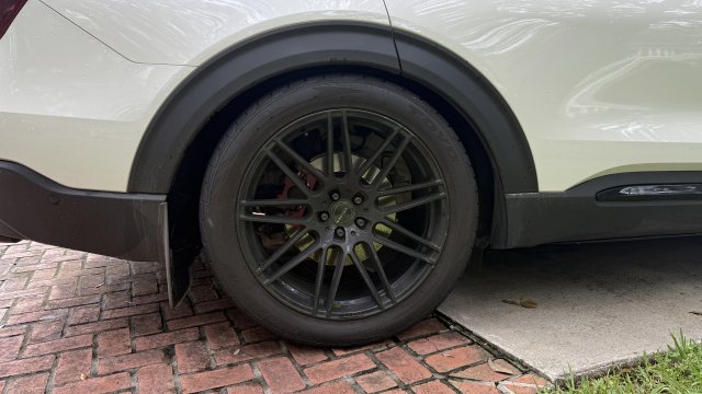

I’ve got 305/40’s on a set of velgens. Eibach springs. When I go over hard bumps or high way bumps I get some pretty nasty rubbing sounds. It’s not affecting forward motion or anything but is pretty unbearable to hear. Just drove from Florida to Maine and back. I’m thinking of getting a smaller diameter tire. Was just wondering if anyone else had experienced this.

Is this about the same clearance you have?
