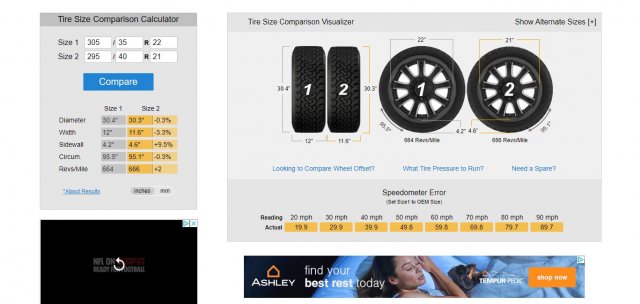

I think I know what I need for 21's. 295/40/R21 on Superforged Baller 21" x 10" rims with 24-25mm offset. That put me right where the popular 22" set-up is fender flush. 10% more sidewall with only a 3% decrease in width. I'm thinking I will still need the rear camber set at -0.5 degrees as well.
I appreciate everyone for their input.

A 315/40 tire on a 21" wheel gets you 30.9". I can't say if it rubs upfront or not, I've only seen it on a staggered setup where they ran the OE size 275/45 up front and did the 315/40 in the rear.
Interesting. It looks like if I go with 315/40/R21 tire I will have the same positioning as the popular 22" set-up but with more tire bulge and slightly taller by 0.5 with a 21" x 10.5" 30mm offset rim. I would be interested if anyone has tried this upfront. IDK might just play it safe with the 295/40/r21.
