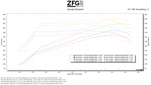

Ryan’s 2026 Explorer ST is officially dialed in and making serious power on E85!
611 AWHP and 590 FT-LBS to be exact!
Earlier this week, @Ryan Chiodo dropped his ST off at Nostrum High Performance for a full Stage X fuel system install so we could take full advantage of E85. We took over for the custom calibration, and the jump in power is incredible.
Here is the hardware setup:
Nostrum Stage X Fuel System & Ethanol Sensor
CVF Downpipes
3" Thermal Exhaust
CVF Hot & Cold Charge Air Pipes
CT Fab Intake
Whipple Intercooler
The Dyno Results
Here is our 93: performance tune vs the 93 Race tune 93 performance vs race.png
And here is e85 tow vs Daily Driver Vs Performance Vs Race! E85 RACE v Performance vs daily vs tow.png
