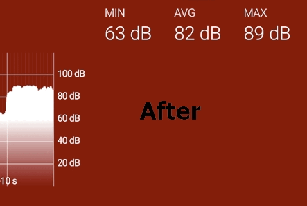

I changed my as built:
ACM > 727-01-02 0000 9204 00C7................. 2 = CC Disabled • ANC Disabled • ESEPS Enabled • MSS Disabled
to:
ACM > 727-01-02 0000 9404 00C7...................4 = CC Disabled • ANC Enabled • ESEPS Disabled • MSS Disabled
But did not change this as-built:
DSP > 783-01-01 5801 00E5.............................5 = R Reserved • APIM Log Missing APIM messages • R Reserved • ANCPS ANC present
Because it already shows ANC present, and I don't see a better option to choose.
I did a before/after sound recording of a WOT 0-60 run, on the exact same section of road, windows up, holding my phone in front of my face, sport mode, TC-off.
I'm going to call this "no significant change".
to:
to:

Did the Fake engine noise get disabled for you after this mod?
It's right in my post. The cabin sounds didn't change significantly. I measured with a microphone.
