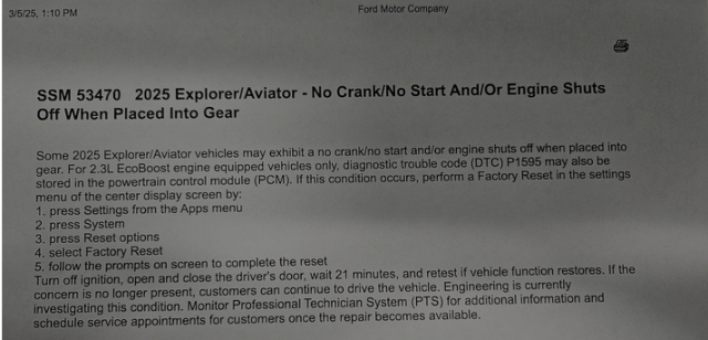

This is not just ST, happened in my ST-Line too. First was unable set cruise control. Next got gas and boom no crank no start. Could with the key fob but as soon as put in gear engine stopped. As I was getting it on the tow, all sorts of errors and no start at all

2025 Ford Explorer with 3800 miles on it. Everything was running fine and right after I filled up with gas, I start the engine and put in in gear and the drive 1 foot and the engine dies. I start it back up and try again and again and same problem except it dies as soon as I put in gear forward or reverse.
I have no check engine light on but after plugging in my obd scanner I got a P161B code. Had it towed to the dealer and he said they didn't see that code. A few days later, they called and said it was purge valve issue.
Anyone else experience this issue? I am thinking about having a spare one handy in case this happens again. This is the first time in 40 years I have broken down and needed a tow. Other times my car was able to limp along to get somewhere.
Update 2/9/25: Its been 1 week since the purge valve was replaced and I haven't had any issues since.

You don't need to do a factory reset to get your Explorer started again. Just turn it off and let it sit for about 10 minutes and it will start and drive again.
