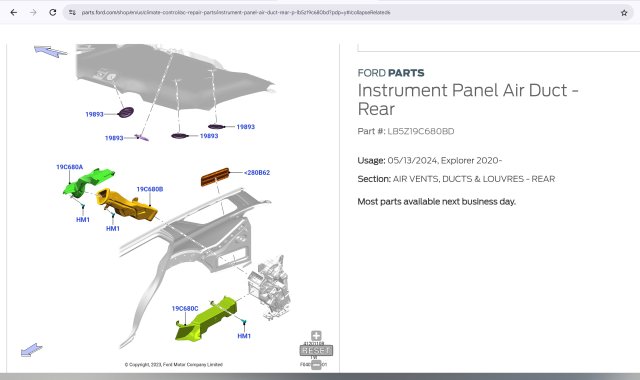

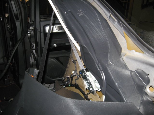

Just purchased a Job2 build (build date 03/29/25) and when turning on the rear climate system, I could hear the fan/blower moving air and the lower heat part works fine, but no air from roof vents, just pulled the c-pillar trim panel and found the duct part connecting the unit to the roof vents is missing, anyone else experienced this? I know easy warranty repair, but just odd how it left the factory without that.
Part #: LB5Z19C680BD (highlighted in gold in picture) is what's missing.
