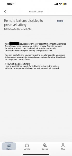

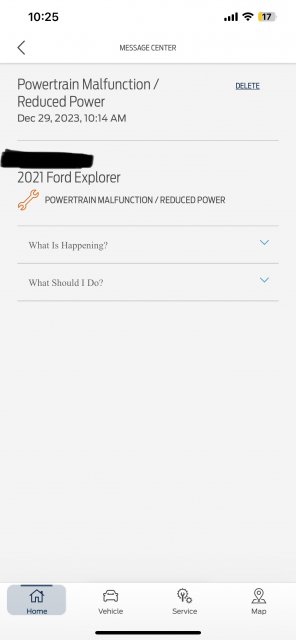

So the towing company did not leave my key in the car so ford was not even able to work on it yesterday. Finally got a message for the tow guy saying he dropped the key in the drop box last night. This morning, got these messages on the ford app, so I guess they are working on it. Waiting for a call. Y’all know what these are?

My 2020 used to get those Deep Sleep mode notices constantly, got the dealer to reflash several of the computers and finally got them to replace the (already replaced) battery and have never had it since. I suspect I just had a couple original lemon batteries that the latest one fixed the issue.

They called and said the pawl solenoid is bad and have to get that part before they can run it for any other codes. I told them prior to it not starting at all that the auto stop/start function happening at traffic lights - letting of the brake for the car to completely turn off (only happened twice). Not sure if it’s related. Also brought up the squeaking noise happening when going over the smallest bumps and grinding noise when taking sharper turns. Hopefully they can see what that is about too. I’ll update.
