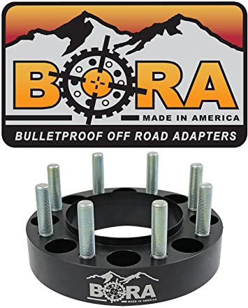

do you have a link to the Bora spacers?
here you go. you are going to want at least 1.25" if you don't want to be cutting your stock wheel studs. I did 1.25" front, 1.5" rear. looks perfect. no rub and maybe protrudes from the wheel well just enough you see tire bulge but no tread.
https://www.motorsport-tech.com

Are you folks using the aluminum or steel spacers?

Aluminum. Per recommendation from Motorsport tech. I even posed the “what if” of taking it to the drag strip with 500+ hp and they said aluminum would be fine. The steel spacers are more intended for rock crawling or 2500+ HD series trucks...

I don't have my ST yet, still on order, but I'm curious if anyone has before and after shots of the wheels with the bora spacers? Also these things basically just bolt onto your stock wheel studs and then the rim goes onto the studs now on the spacer correct?

That is correct. As stated earlier in this thread, if you go with 1.25" or larger you don't have to do any trimming. Personally, I think 1.25 on the front puts the wheels out too far so I went 1.00 front and 1.25 rear. I haven't received them yet or I would share pictures. They are supposed to arrive next week and I will share before and after pics once I have them installed.
