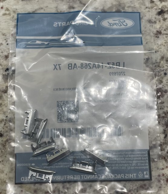

The part number for the bag of seven tips is LB5Z-14A268-AB as shown in the bulletin. A Google search of the p/n led me to a dealer right up the road in my state. The cost was about $8 with $7 added for shipping.
The tips as they arrived:

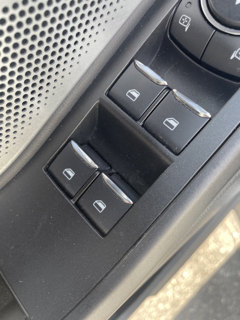

From the bulletin, Ford states to grab them with cutting pliers and pull, but that is a real pain. All you need is a small screwdriver. Carefully push under each tip forward, and they all pop right out.
My drivers side switches before (with the sharp flakes of chrome scraped off after a couple cuts on my finger tips):
Good as new after about ten minutes of work (changed out on all four doors). A no-brainer.
