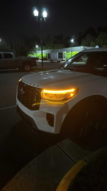

We've been working on mine for the last 3 days. Even plugged into a LEO explorer to see anything different. The pic is right now. Here's what we've got...
1. Switched to "auto" the ambers come on and run as DRL and flash with turn signal.
2. The LED bar STAYS OFF. (thank lawd)
3. Here's where it gets sticky.. when switched to "parking and/or head lights" the front ambers do not flash with turn signal. The mirrors and rear flash, but fronts do not.
We saw a post, where someone had it to where when "parking/headlights" are on at night, the LED bar came back on, and the ambers went out. That is not how the LEO explorers work. At night, the amber is still on with headlights.
We've tried all the codes that ppl have posted, and nothing is working. We've been in to "AS BUILT" & "PLAIN TEXT" modes to change stuff around, and no luck getting the ambers to flash "turn signal" at night. I don't like the LED bar, it does not look "sporty" to me.

The LEO explorers have dimmer Amber DRLs, about 50% as bright as ours at night. The reason our blinkers do not work is because our Amber DRLs are constantly at full brightness, which makes the blinker impossible to see. What we really need to know is if there is any code in the BCM that we can add or modify to make our Amber DRLs run at half brightness at night. With that would you to get the pulsating amber (bright>dim>bright>dim) when you use the blinker. I also noticed that the LEO amber lights only come on a night, which means they're actually using the "position" light mode and not DRL mode. So to reiterate, we need the amber lights to run at 50% brightness when in "Position" mode. Seems that would solve the problem.
Worst comes the worst, it's a physical modification to the LEO headlight units that gives it the behavior it has.

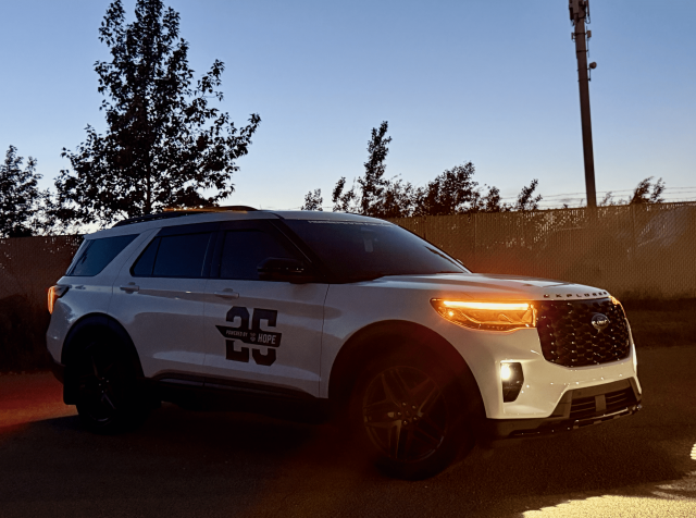

It’s a hardware limitation, not software. I’ve already looked into this alot (throughly), there’s no way it’ll achieve what you want unless you change your headlights to the PIU/base Explorer ones. That’s because the marker and turn signal is into one on PIU where civilians on higher trims, side marker and turn signal is separate. If you just make the 2 BdyCM asbuilt changes, you’ll get the turn signals working during the day but in marker 1/2 on headlight switch won’t work. I managed to get both working for during the day and night time, for tons of response for it on Facebook groups for 2025 Explorers haha.
Looks soo good! (Night time, in drive, mode 2 on headlight switch. Can use fogs on/off whenever you like).
