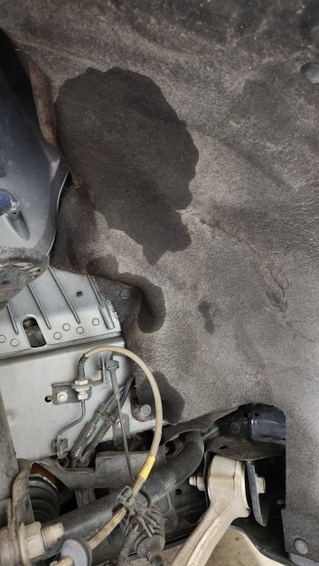

Late to your thread, however, after washing my Explorer over the last two weeks, I have noticed the blue washer fluid pooling under the right front.
I isolated it to dripping quite a bit, however, cannot find a leak, as the tank itself is buried inside some plastic panelling.
