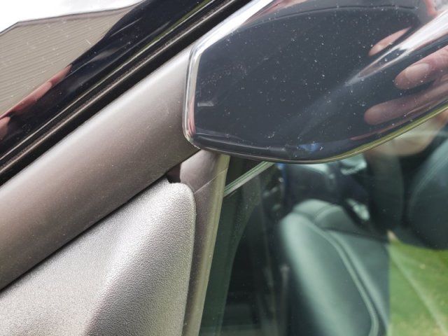

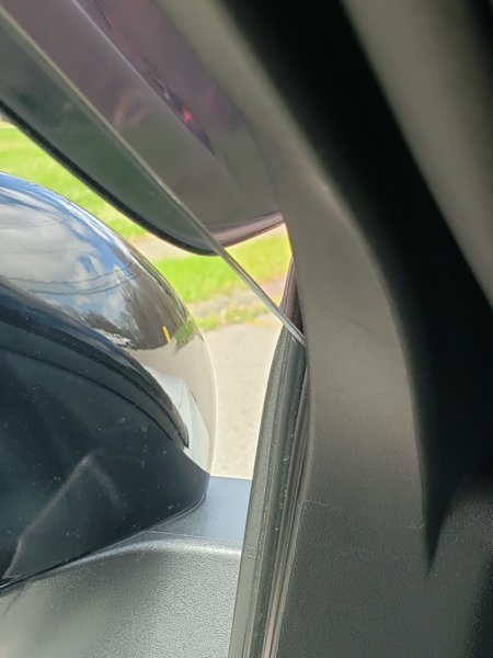

You don't have to take my word for it, but those low-profile versions really suck. They attach poorly to the driver and passenger doors (many out there have had them fly off), and when you drop the window a 1/2" or so, there is a big gap at the front, which defeats their whole purpose. I put it all in the thread I linked up there. The standard versions fit full length and are the way to go. So glad I swapped mine out, especially since Lund/AVS listened to all the complaints and came out with them.
Here's the gap in the low-profile set, which lets in lots of wind noise as well as rain:

I have the original low profiles. For looks they are fantastic.. for function, not so much. Didn't even know they were redesigned so I'll be looking into swapping them out I'm sure.

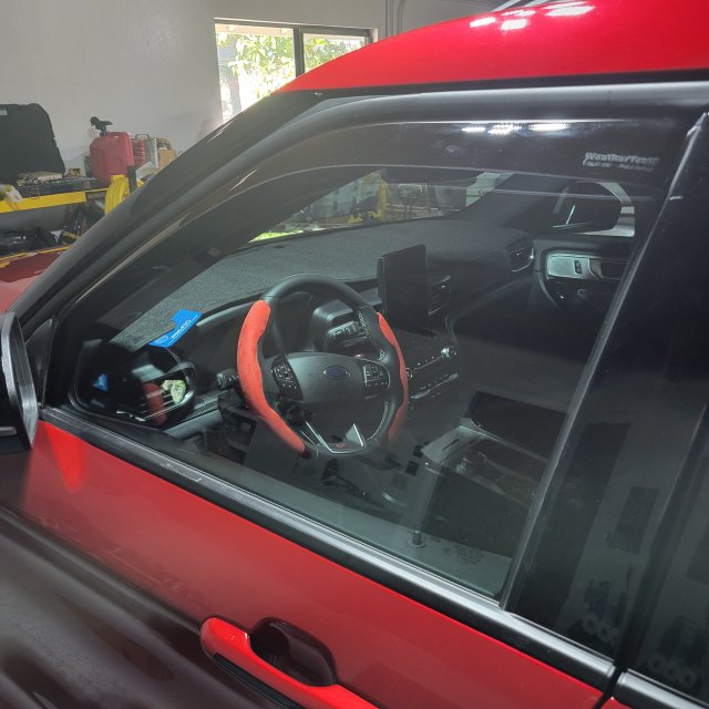

I received the deflectors yesterday and installed them. Fitment is really good. Unfortunately, for both sides, when I go to inch the window up for the first time, the plastic lip on the front edges and tips cracked. I didn't read anything about not installing them in the cold but customer service says that they should be installed when it's 50*F or higher. Thankfully, they are sending me a replacement. They do look good and the flare on them, as well as the front edge coverage, should perform better than the AVS.

Here are a couple of images of them installed.

Took your advice and installed the deflectors after my garage got above 50'F. Learn from others!
They went right in. The hard part was 'slowly' raising the front windows without the 'automatic full up' activating. Now I have to wait a couple days for them to settle before opening my windows again.
Question: I know it's too late now. But did you leave on the little plastic (tape?) on the very front edge? I wish I took a picture of it.

Yes. It just prevents the edge of the plastic from cutting the rubber of the window surround. It looks a little like packing tape but a closer look shows them to be a slightly thicker vinyl tape.

Does anyone know if the "Weathertech" logo is removable? Looks kind of like just a sticker but also looks like it might have been imprinted on there.
