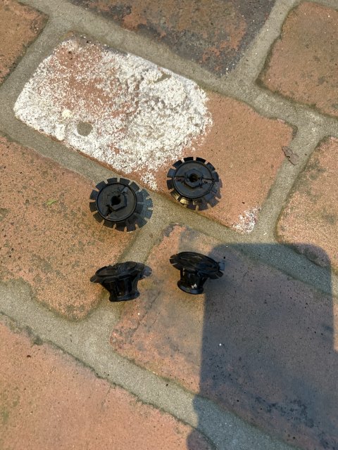

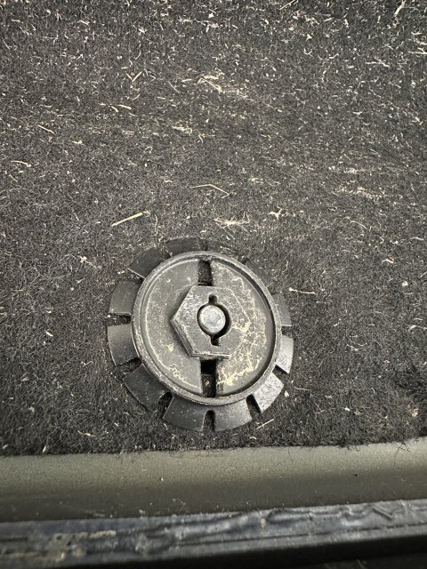

Start by using your hands to press the fiber underbody (feels almost like cardboard egg carton). There’s probably 10-12 connection points on passenger and less on driver (maybe 8-10). On the outside edge, below the front and rear doors, is where the crappy plastic nuts are located. It should be loose in this area (push fiber underbody up - any loose is too loose)!
Rip’em out! Pic below shows you can use small flatheads or long thin needle noise to release the clip, but it’s more enjoyable ripping out.

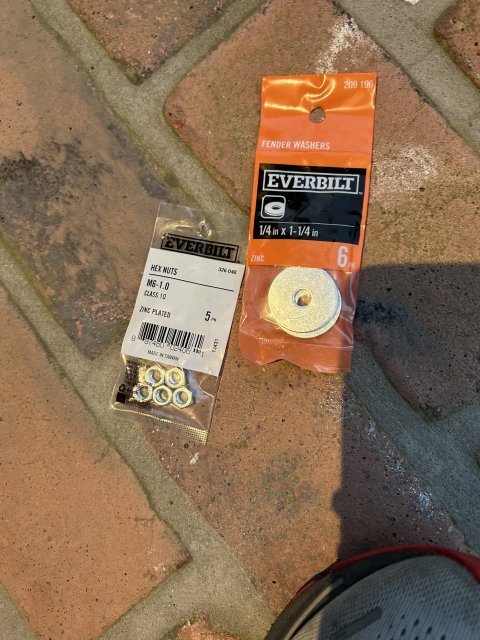

Get M6 nuts and big washers (pics below from Home Depot). I used 10 of each. Replace plastic nut with washer and nut. Use 10mm socket or hand and tighten. Repeat on both sides.

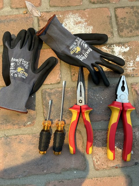

Another pic of tools for the job. And don’t forget a nice piece of cardboard to lay on.
