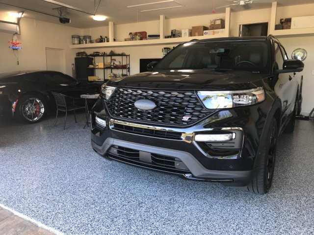

I did XPEL PPF
Door handle cups
Full hood
Full front bumper
Headlights
