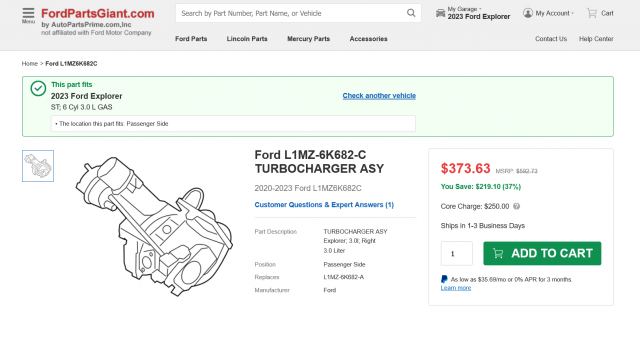

I thought the same thing but when I was told 890.00 new I just said go ahead and get it done. Let's just hope the other hangs in there.
Hell you can buy one yourself for less than $400
497
480
Most of the cost is labor. Seems to always be that way. Parts are pennies of cost compared to labor cost.
