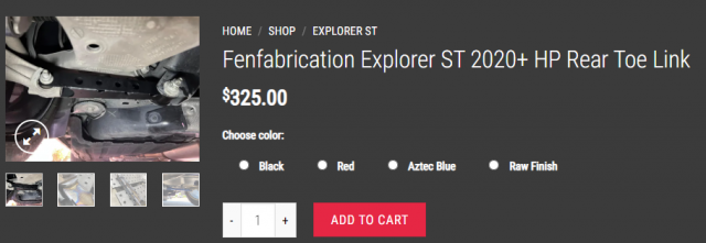

All I did was leave the weight on the car…backed up onto ramps. Scribed the eccentric and frame so I could put it back how it was then swapped the links and lined the scribe marks back up. Zero issues…the finer the scribe mark the more accurate you’ll be.
I see the scribe marks in the photo on the FenFab website. Sweet. Thanks!
Where is that scribe mark? Looking at the photos on fenfabs website I don’t see it at all.
