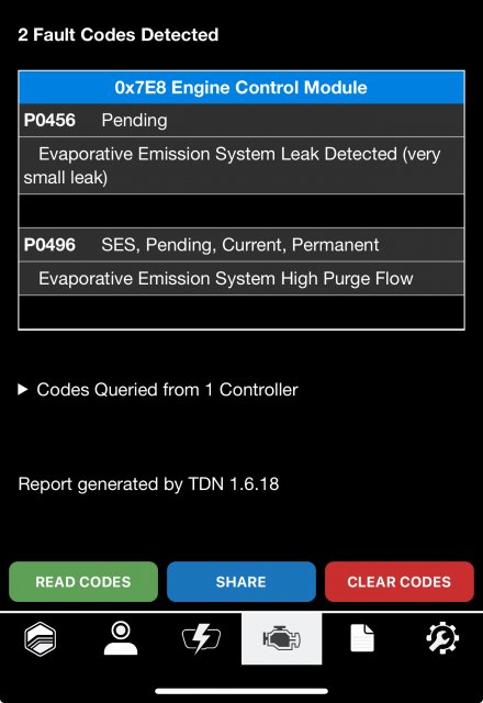

IMG_3251.jpeg The explorer is also hesitating to start when I fill it up with gas. I think one of the codes is for some kind of valve sticking open. Is that also the “small leak?”

Purge valve is hung open. Get a new one.
Is it hard to replace? Does this happen often?? Thanks unbroken you quick on the responses
