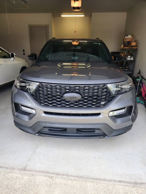

Next, opened up the front bumper/grille to install the Emblem City black on black Ford badge. Despite the poor lighting here, it looks great. I'll get another shot sometime this week, probably.

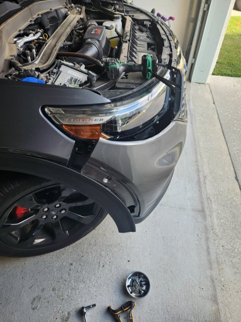

Some notes about that install:
- I only popped loose the passenger side and center portion of the bumper. That left me enough room to get my arm in there holding a 10mm socket and unscrew the badge. I'm a pretty big dude with big dude arms (humble brag), so if I can get in there, I'm sure most people can do it this way. My arm took a little damage in the form of some imprints having the bumper press into it, but it seemed easier than popping loose the other side.
- The 10mm bolts you access behind the wheel well liner weren't that difficult to get off from an "OMG, why are these so tight?" POV, but they were a huge PITA for someone who doesn't have a universal joint for his sockets. Like I said, big dude trying to do this relatively quickly, so leaving the wheels on and getting a wrench up there was a tight squeeze and I could only turn the bolt about a quarter turn at a time. VERY thankful they weren't super tight.
- The only thing I broke this time was the little pinch clip between the 10mm bolts. No big deal.
- In retrospect, I think the way to do it is Unbroken's "drill the studs off from the outside then VHB tape the new badge on", unless you're taking the bumper off for an intercooler install or something already. The badge is plastic, so weighs just about nothing and should be fine with tape.
