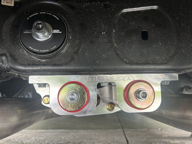

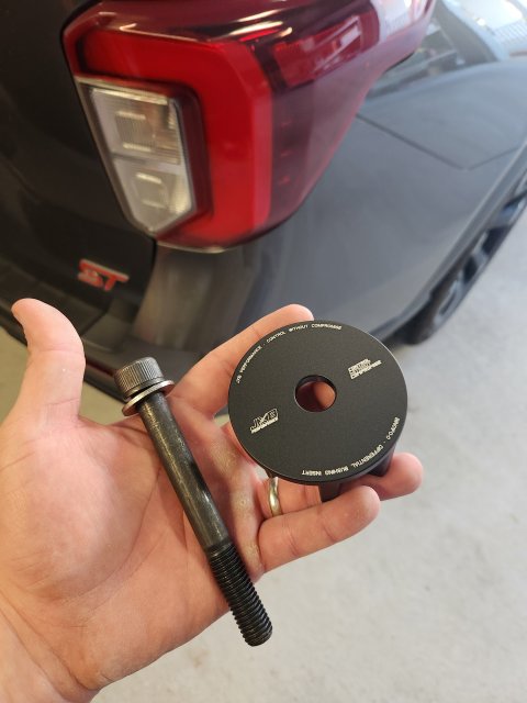

OK, second foray under the car.
This wasn't hard but I don't have an impact wrench and I did it with the car on the ground. Doable but you have to contort yourself a bit to get leverage on those big bolts. An impact wrench would make this infinitely easier.
Didn't get to drive it yet because of reasons but this is the first performance mod I've done to the vehicle and I'm excited to see how it changes.

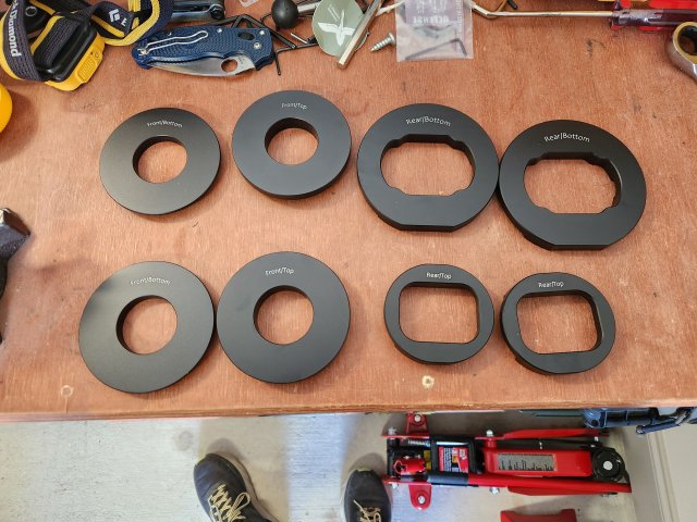

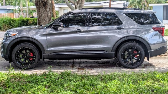

Installed Eibach lowering springs today. Measuring from wheel center to fender, the front dropped 1 3/4" and the rear dropped 2 1/4". Measurements and after pic was after driving around over a half dozen speed bumps, a couple of launches and general driving for about 30 minutes. It no longer does the floaty bounce over the neighborhood speed bumps, slightly stiffer ride as expected, feels much better. I will be doing a rear sway bar to go along with it.
I have done a bunch of other things over the past two weeks since buying it: Husky floor mats and cargo liner, hitch cover and locking pin, mud guards, anti glare screen protector on head unit, silicone license plate frame, black Ford emblems, Gorilla black lug nuts, Radar Mount and wiring, front windows and top of windshield tinted, Covercraft windshield sunscreen, ST pedal covers, Mishimoto catch can, removed hood lettering.
And more parts are on the way or to be ordered still.
Before
After

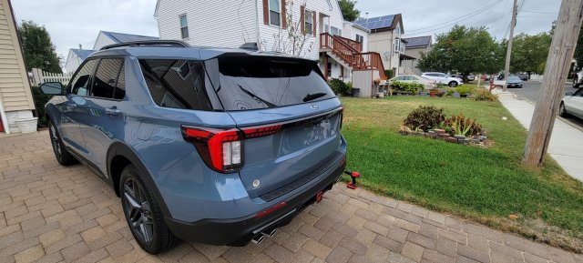

Black badge in rear, black lug nuts (the chrome looked off on the gunmetal hubs, hitch cover (don't love that, as it's 3D printed). Red valve stem caps. And right after this, a set of non-temporary license plates!

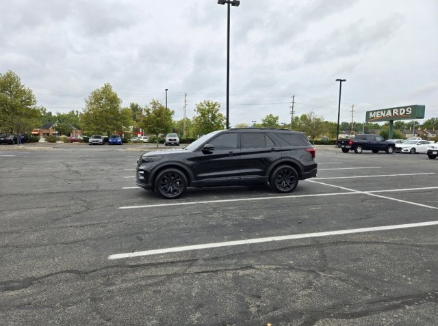

Finished making her nice and dark. Screenshot_20240927_034605_Gallery.jpg Screenshot_20240927_034951_Photos.jpg

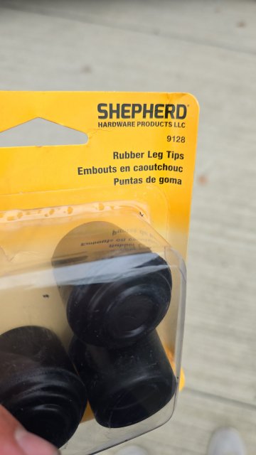

And installed a furniture leg protector VTA (LOL). [Not sure that's a permanent mod but I got bored and it cost me a dollar 98. IMG-20240926-WA0045.jpeg
Roof rail delete next. Give me some confidence about how easy it is
@BrooseDaMoose tagged you so you could see how the wheels turned out. Just plastidip with a top coat of luxury metal. (Worst plastidip product I've ever used in my life, and I'm a life long dipper) Turned out good IMO, I like how they match the plastic moldings. Until I do paint matched.

Finished making her nice and dark. View attachment 25418 View attachment 25419
And installed a furniture leg protector VTA (LOL). [Not sure that's a permanent mod but I got bored and it cost me a dollar 98. View attachment 25420
Ok you got me. What was the leg protector for? Good looking rig!

How did you apply it? Spray? It looks good!

Yes, I did five coats of black, and two coats of luxury metal. I've done Plasti dip on a bunch of my cars. Fonzie has some good videos on YouTube. I'll share some photos of all my emblems later.

Haha! It's probably on the forum somewhere here, it's an old EcoBoost trick. You buy 1 in furniture leg protectors, and cap off the return into the air intake. Essentially turns your blow off into a vent to atmosphere system.

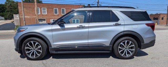

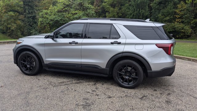

Got the Car back from the dealership yesterday Power folding seats are now fixed. This Morning I got the new Rims installed and I think it looks better now. before and after. Since the before picture was taken I have added front Tint, Door handle black covers, Embossed Explorer decals for the doors. Debating on painting the calipers RED or sticking with the unpainted silver look and keeping the car silver and black all around.
