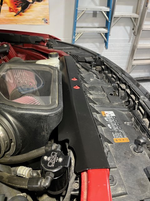

So for me I was about a half hour from putting my wire cover on the front frame but got a little careless with the buffer and burned through the clear and paint on both outside corners… starting over but have a good base so hope to have it on Saturday. IMG_0648.jpeg

So for me I was about a half hour from putting my wire cover on the front frame but got a little careless with the buffer and burned through the clear and paint on both outside corners… starting over but have a good base so hope to have it on Saturday. View attachment 24701

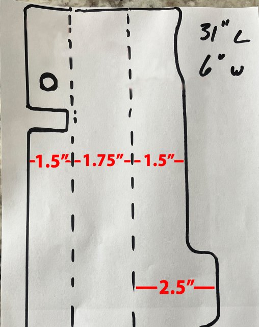

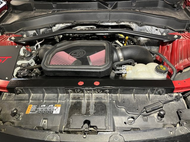

So I got it finished and installed... Here are some pictures as well as the template. For the template the dotted lines are where it is bent and in the bottom right is the side view so you can see the angles... IMG_0655.JPG IMG_0656.JPG IMG_0657.JPG IMG_0658.JPG IMG_0653.JPG Bend Dimensions.jpg
PLEASE NOTE THAT THE TEMPLATE IS MIRRORED… THE TOP SHOULD BE THE BOTTOM.
