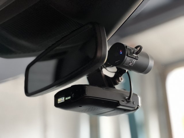

Swapped in an Escort M2 dash cam to replace my M1 and modified the mount I made to attach it to the Blendmount…now the camera is tucked up behind the mirror and completely out of sight. IMG_1549.jpeg

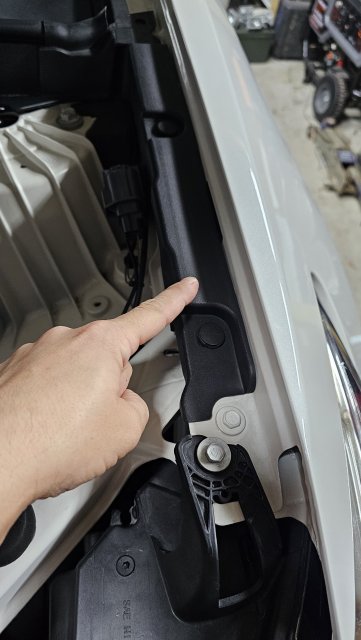

Got the MRT hood struts on, after a few issues that MRT took care of for me. That being said if you have extra plastics under the hood there's a lot more trimming you have to do other than what's in their install video. This piece underlaps what they tell you to trim and it has to be modified as well for the hood to close. 1000018445.jpg

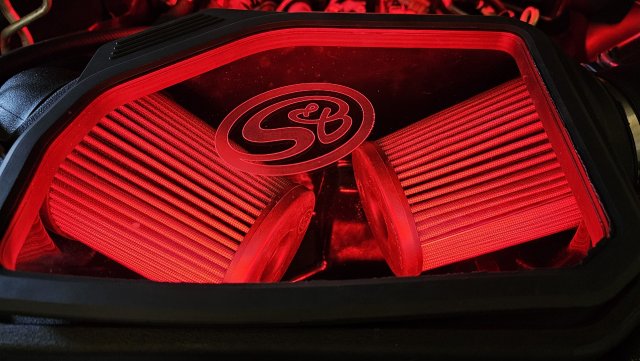

Finally got it ready for a little more power!

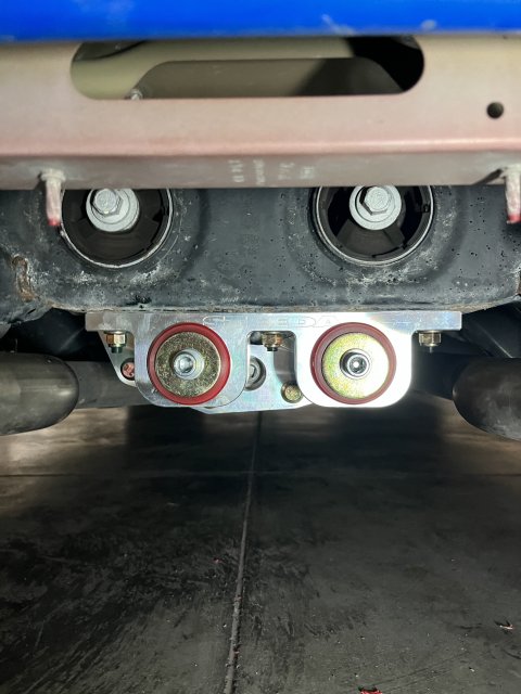

Just installed the Steeda subframe spacers… I think they are must haves! As previously mentioned it is much more planted and gives you better feel for the road. The hard shifts seem softer and the power gets to the ground much better. Launch was better with a huge bark of the tires when shifting in to 2nd and 3rd gears… used to get some chirps.

This is a must-do mod even at stock power levels!
