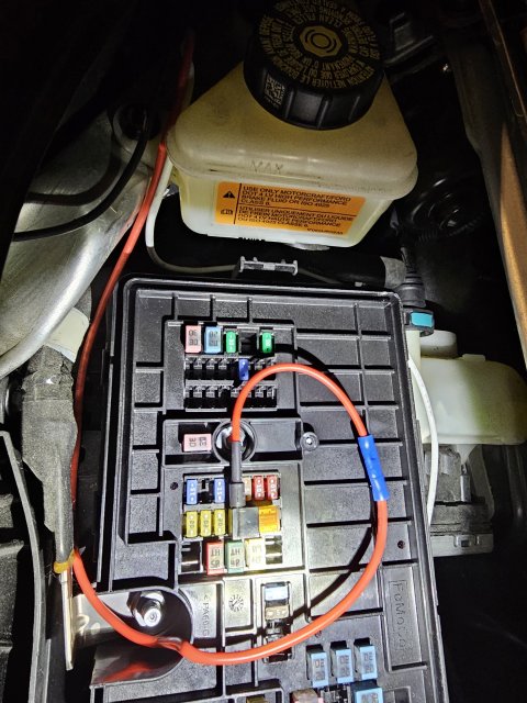

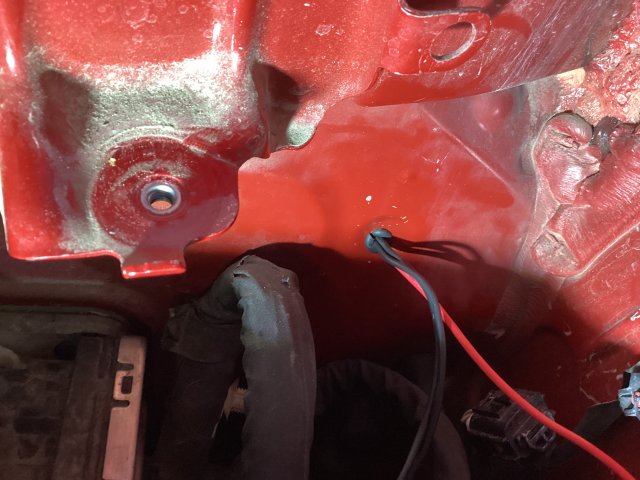

Okay, I ordered the Continental Ethanol Gauge from P3 and now have everything needed for install. The Ethanol sensor install is obviously a no brainer but wanted to do a sanity check on the wiring... Is it really as easy as Red/Red, Black/Black, White/White, Blue/Blue, Brown/Brown for connecting wires? Also, what fuse location is everyone using for power and where do I connect the "Dimmer" wire?
74
79
texas
Yes, the wiring is just that simple. Be sure to mount the P3 ethanol sensor adaptor inside the vehicle (its not waterproof). I didnt use or connect the dimmer wire.
