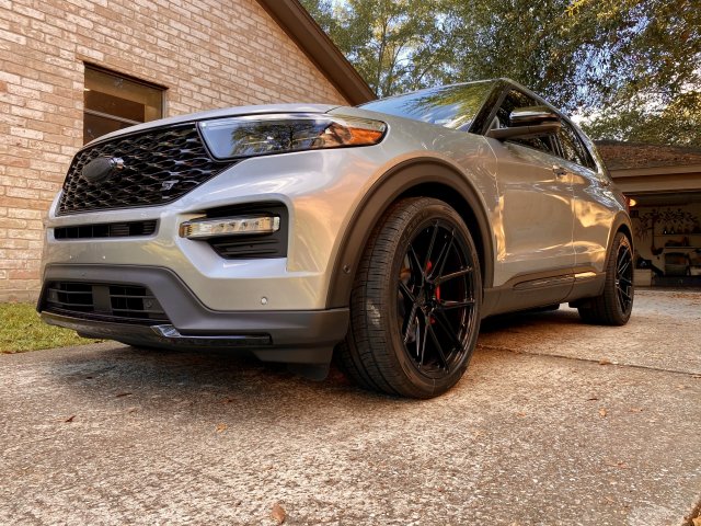

These are BC Forged EH181 22x10.5 +30 with 305/35 Scorpion Zero Asimmetrico’s and H&R coils. No rubbing and no issues.

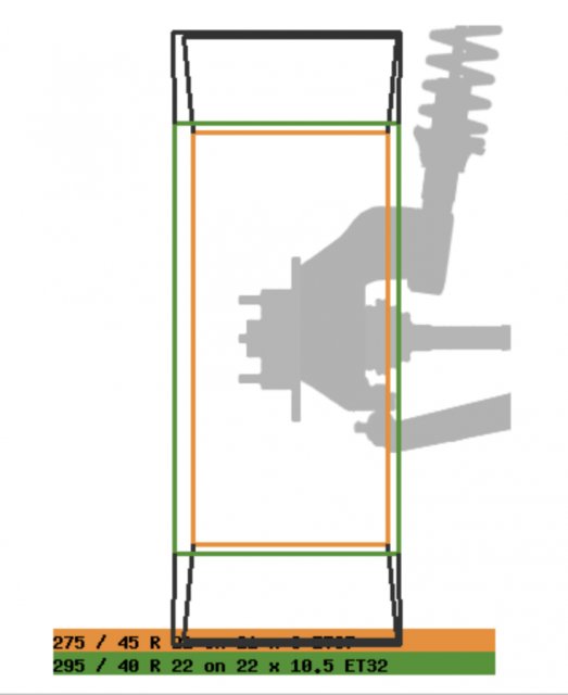

Stock 21s compared to your set up.
