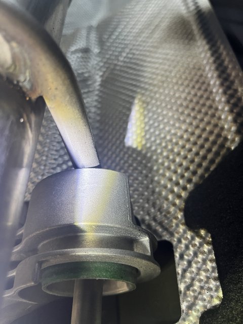

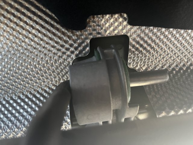

Well… another try at a fix and I think I may have gotten it… the issue came up around when I installed the MBRP exhaust on the car but I didn’t want to think it was related…
so after my wife got back from making a run to the store… the video I posted was over her trip today…
I put it on the rhino ramps and started poking around underneath…
I looked at the first exhaust support to make sure it was tight bc I loosened it to install the exhaust and it was still tight…
but when I installed the exhaust I noticed the hanger was a little close to the mount but I didn’t think anything of it… but upon closer inspection today I think this may be my noise…
I think it was the hanger from the MBRP rubbing on the factory mount… I loosened the exhaust clamps and adjusted the exhaust to give it a little more room… there are even witness marks on the hanger to indicate they were touching at points… 8C0F5A64-3651-4ADB-9D1B-CB48E0C36014.jpeg 9FBCFE0E-846E-4F5E-9081-8F5607FF4B64.jpeg A6FC7E17-123A-4CC9-9D8D-925E337DAF2E.jpeg
the first 2 pictures show how close the mount was and then the 3rd picture is of how much of a gap I was able to make…
you can see witness marks on the hanger too
the tell tale sign of this is that squeak in the video… that squeak sounds exactly like aluminum and the factory mount is aluminum so this may be the my issue… it would probably still be a good place to check even on a stock exhaust explorer…

Looks like you got it, I hope that’s all it was. These vehicles do have some “Normal” strange noises and when you encounter a noise that’s not normal, it’s a good feeling when it turns out to be an easy fix. Good find man!

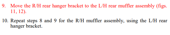

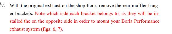

In the instructions to install the BORLA S-Type they make a note that you should switch the RR and LR mounting brackets. This may fix your issue as well since they will be reversed. Borla even put it in red most likely from receiving phone calls on installation issues as no body reads anymore, easier just to look at pictures.
