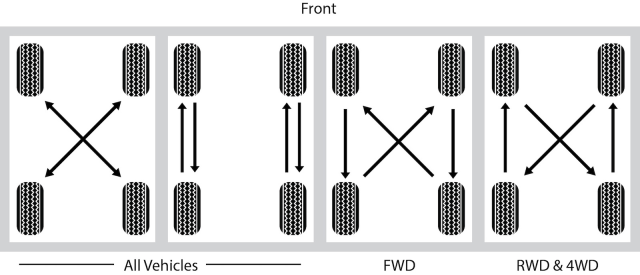

Where do you sense it? Steering wheel, seats, foot pedals? You could try rotating your tires.
