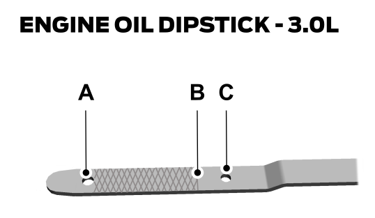

I have an urgent use for my vehicle tomorrow morning, so I was checking my engine oil levels and found it was as low as (or close to) a quarter (or perhaps little less than half) way between A & B on the oil dipstick.

Where is the level after sitting for multiple hours ?
You want it between the top hash and not much over the upper dot.

Make sure you're giving the engine enough time for all the oil to drain back into the pan when checking, perhaps 20 minutes after it has been driven. Even better, check when cold. I'd also probably want to pull my plugs and do a quick read on them. If you've got an individual cylinder using oil, it's usually easy to pick up on.

Anyway, I don't know if this was a false alarm or what, but I opted to re-check the oil in the early am with a flash light. This time, I wiped the dipstick and made sure it was 100% dry, so when it came out it gave me the correct indication, which was at or slightly less than B.
Apparently, the issue happened because the oil on the dipstick was initially very faint, to the point it was not visible under sunlight, compared to what I had been used to seeing when I checked in the past.
At that point, this made a little more sense to me. And given the heat we've been having around here, some of the oil definitely burned off :sneaky: (!).
I poured in about 3/4 of quart and ended up at the C marker, or perhaps a little over, then went about my way, ripping it on E30 :D.
