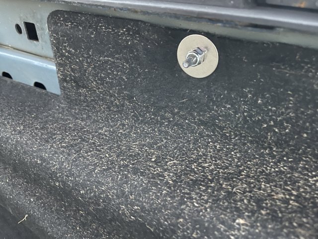

I’m sure all of us have been annoyed by the rattling of the undercarriage cover. What are some PERMANENT solutions y’all have found? Dealer tightened it but a month later rattling again!

Replace all those plastic nut pieces of crap with 1” stainless fender washers and nylock nuts.

Mine is the actual rivet next to that bolt that is always going loose.
