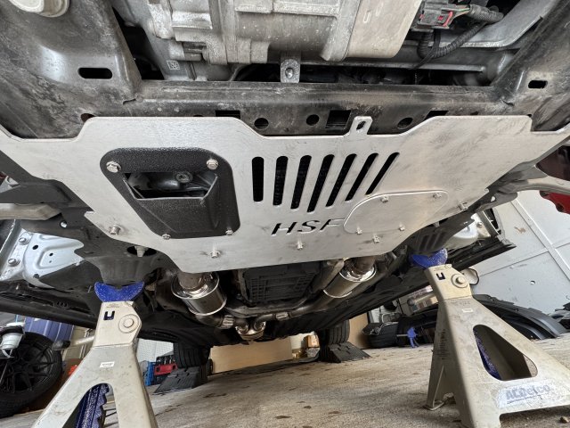

I didn’t like the tiny oem hardware holding the skid plate on…and I do like overkill…so I added 5 riv-nuts for M8-1.25 socket head bolts and it’s definitely solid now.

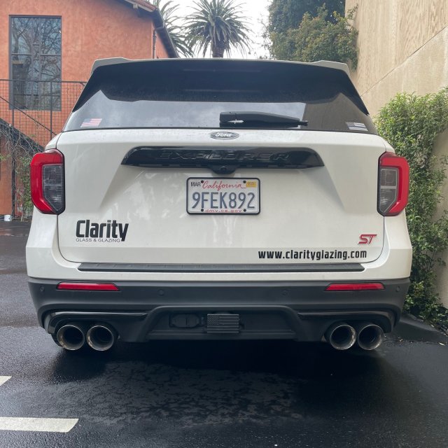

Thread Starter #1,309

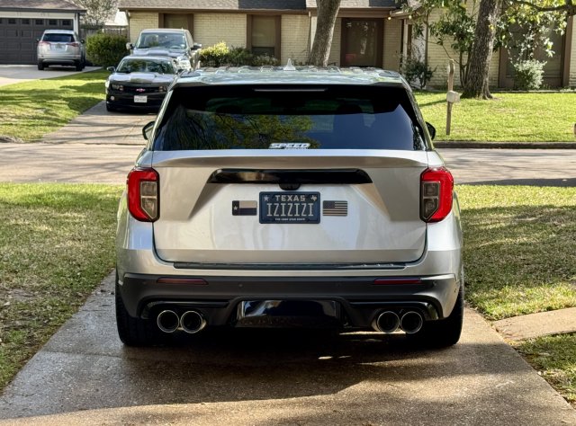

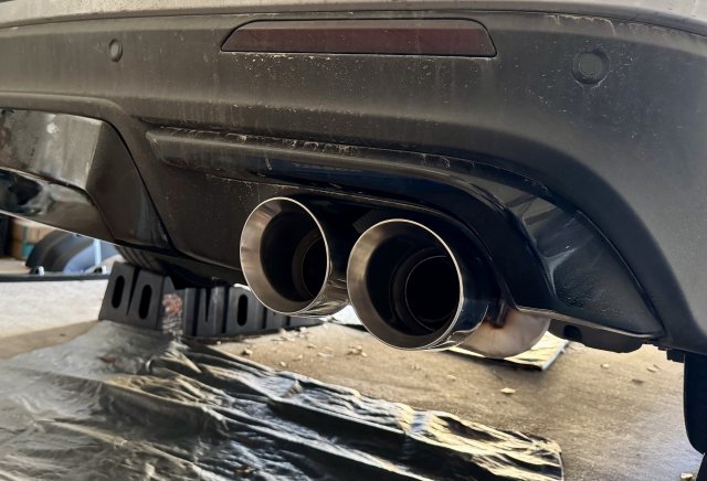

Ok…do the China dual 4.5’s fit? Yes and no. Yes they fit the bumper just fine and the length is long enough to slip onto the muffler outlet but the tip inlet is substantially larger than the muffler outlet. I had to cut a sleeve from 3” tubing then cut that in half to take up the slack. Once I drive it a bit and let the exhaust settle and readjust it I’ll have throw a tack weld on to be safe.

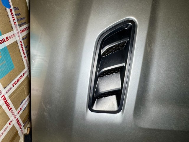

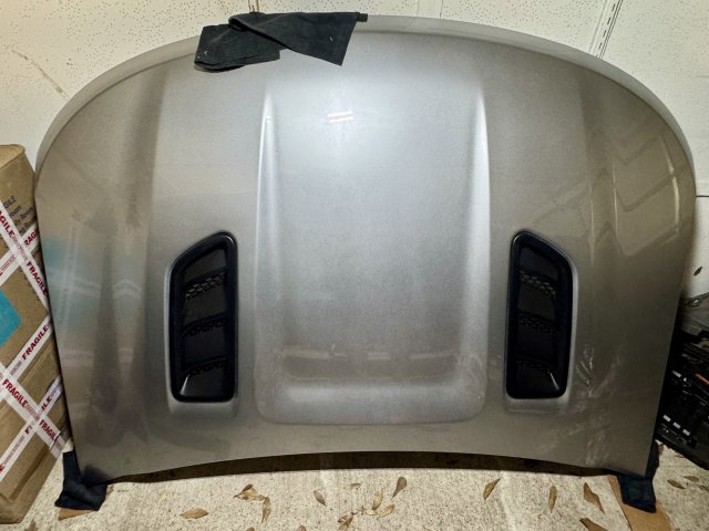

Everything is back from paint and better than I hoped. Reassembly tomorrow. IMG_6006.jpeg IMG_6005.jpeg att.KsFtmjgSI7ItyDflMKnxH3Ab9yeVIIdL7NHQrqiR8Wc.jpeg

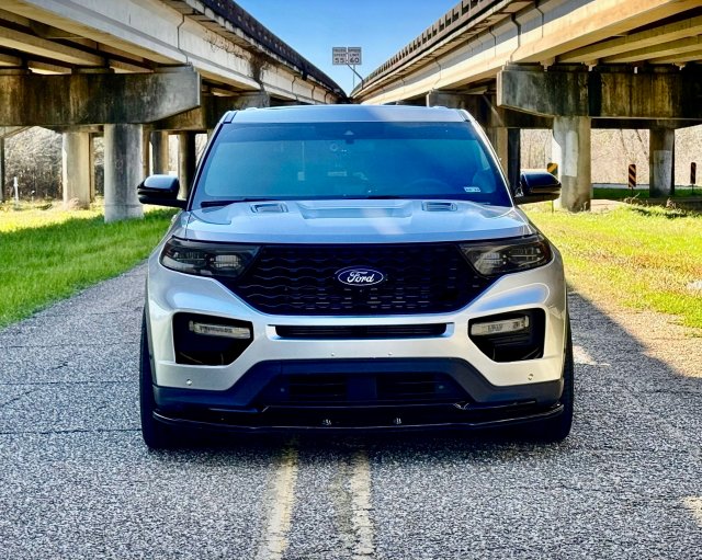

It came out as well as I could have hoped. Pretty much spot on to my “render”. Still needs a lot of cleaning and paint correction on the rest of the car and I can’t wait to get the new wheels on. 6CF122A3-8210-4919-BB3C-C07014A48160.jpeg IMG_6014.jpeg View attachment IMG_6015.jpeg IMG_6009.jpeg

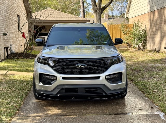

Thread Starter #1,318
What is different with the euro headlights compared to U.S.?
Sent from my SM-T307U using Tapatalk
They have a clear va orange reflector on the side. I haven’t had them on at night yet so don’t know if they’re the same brightness or what. They do have a height adjuster for both beams unlike the US lights.

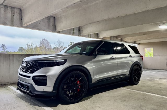

Thread Starter #1,319

Dayum.
Fit and finish look really tight.
