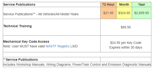

The service manual says to drop the engine approx 5 inches and remove one engine mount then raise the engine back up and reinstall the bottom subframe bolts, then replace the turbo on that side, replace the engine mount then repeat on the other side. I've never done it, You may want to subscribe to the online service manual, lots of components to remove. I've found most of the Service manual procedures difficult to follow because I don't have a lift.
https://www.motorcraftservice.com/Home/Pricing
