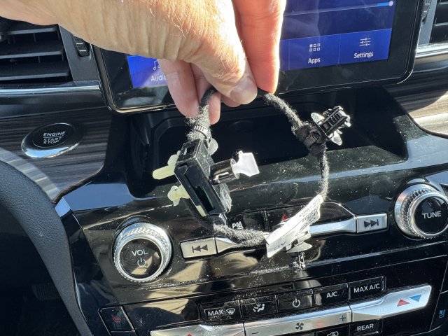

Aviator screen swap people. Has anyone dropping from the 10 inch to the 8 inch bezel added this light for the under tray? Is the harness in the car already? IMG_5565.jpeg IMG_5566.jpeg

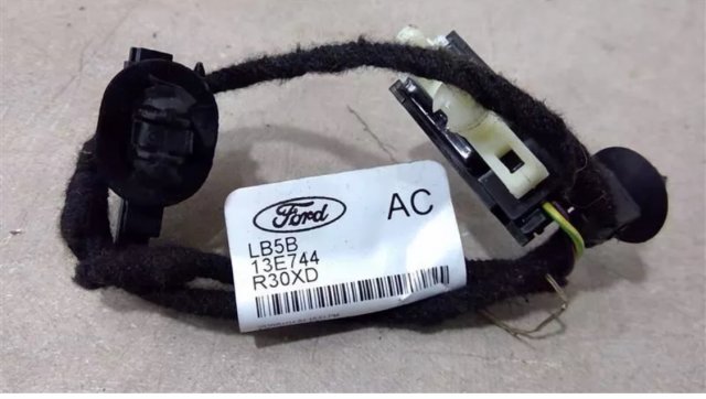

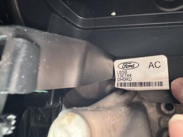

I’ve learned the 10” cars don’t have it.
here’s the PN and a pic.

Interesting find. Thanks!!!

@UNBROKEN haha do what you gotta do. Which trim was that? And who did you rent through? I am wondering about that wood trim to replace the faux carbon fiber.... :devilish:
5,018
6,010
That was a Limited.

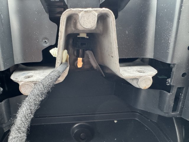

Did you find where this light plugs into? I’m preparing a swap and ordered the light.
Man it’s deep down in there. Take off the radio bezel completely then remove the module that behind it…then hunt down the plug end on the harness.
