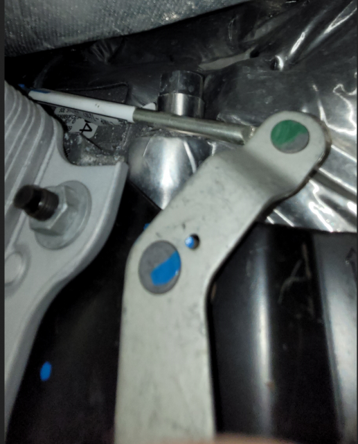

Is there a simple way to check the fluid level of the transmission? I did a google search and didn't find much on the new 2020+, but the one thing I did find showed to check the fluid you have to be under the vehicle.
176
81
There is no dipstick, your finding is the first I have heard we could check it ourselves. Where exactly can we check the level under the vehicle?
176
81

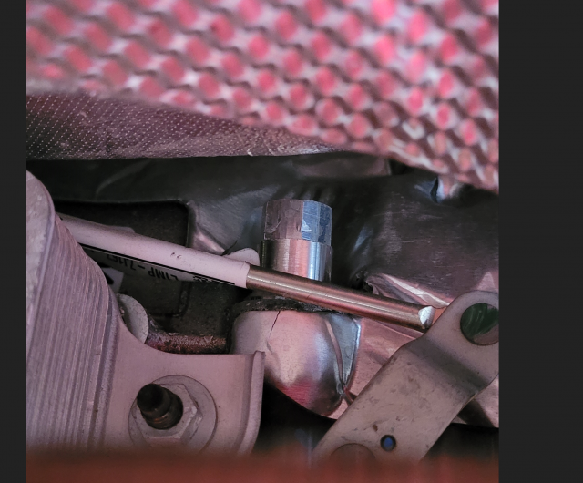

I am pretty sure this is the dip stick, I can see a ton of frustration and maybe even a rounded off head or two if people try and check their fluid level...
84
Sechelt, BC, Canada
That looks a lot like a crack in that casting, might want to have a closer look?
1,502
The "ball-sack" dipstick tube. Is that a stress crack to the left in the first pic?
176
81
Yeah I didn't notice the crack when I took the pic..... I wonder if they over torqued the dipstick when they put it in.
I guess I can call the dealer and see what they say, I have a feeling their response will be if it isn't leaking don't worry about it....
boosted_st
369
221
Airizona
If that is the dipstick, that's just horrible. The reason I wanted to check is because of the behavior of the transmission after the tune I have. I contacted them about the feeling of the 1-2 & 2-3 shifts feeling like they are lurching into gear, and they suggested checking the fluid level as they have seen lots of F150's not having the correct level from the factory. But not sure I'll be attempting to check the level on this thing! why make it so hard to check the fluid level? :unsure:
176
81
I didn't see anything else that was close in the area of the posted image, the cooler is in the way so it could be behind the cooler.... I am pretty sure what I found is the dipstick
Dale5403
2,155
2,350
Mondovi, WI, USA
Here is a short video showing it. Looks like your at the right spot.
105
Atlanta, GA, USA
Yes, what you found is the cap to the dipstick. Take the silver cap off (19mm I think) and there is a plastic dipstick under it.
176
81
I wont be touching it until I talk to the dealer about that crack on the boss for the dipstick. I am assuming it will be replaced under warranty, will be interesting to see how long it takes for the new transmission housing to come in.
176
81
Update
That is a very well molded heat shield where the crack is, I am taking it in tomorrow to have them check to make sure nothing is going on behind it but the trans should be fine.
