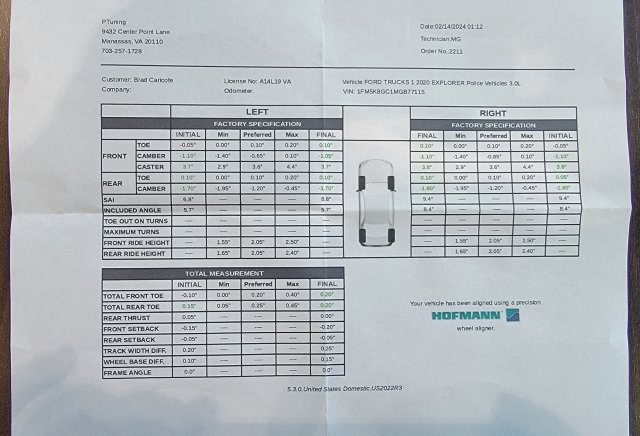

Looks like some posts got in before me. Can you show us a copy of the alignment printout? One last thing, does it have stock wheels and tire size?
Yes, stock wheels and replaced the oem pirellis with same size Michelin Pilot Sports today.

This is kinda crazy because both worn tires and new tires can cause what you are describing. This can be related to how the tires follow the grooves worn in asphalt by normal wear and tear on the roads. I can't imagine the Michelin tire being a cause here but I've been wrong before.
Most of those alignment numbers look good to these eyes. I'd probably want a little more positive camber all the way around if it were mine but you are in spec and in your situation that could exacerbate what you are feeling. Not only that there is only a limited amount of available camber adjustment on these vehicles.
Have there been any modifications or damage (hard speed bump or divot) to the front end? I don't have any idea what the actual spec is for the Steering Axis Inclination (basically a fixed angle). Included Angle (IA = SAI + or - Camber Angle). Alignment equipment doesn't usually show these values because the SAI isn't adjustable per se. That value is related to front-end parts (steering knuckle, for instance) and frame or body position. These shouldn't ever need to be changed unless something is bent or broken. Body shops typically have those numbers.
Those two measurements seem to be a long way apart. Old school (that's where I'm from) Techs were taught that these numbers shouldn't be more than 1.5 degrees apart, side to side or you would feel it. This changed a bit on dedicated front-wheel drive vehicles.
I think the first thing I'd look at doing, given those numbers is to find out what Ford says the SAI number should be and what tolerance between two sides is acceptable.
Most of those alignment numbers look good to these eyes. I'd probably want a little more positive camber all the way around if it were mine but in your case that could exacerbate what you are feeling.
Have there been any modifications or damage to the front end? I don't have any idea what the actual spec is for the Steering Axis Inclination (basically a fixed angle). Included Angle (IA = SAI + or - Camber Angle). Alignment equipment doesn't usually show these values because the SAI isn't adjustable per se. That value is related to front-end parts (steering knuckle, for instance) and frame or body position. These shouldn't ever need to be changed unless something is bent or broken. Body shops typically have those numbers.
Those two measurements seem to be a long way apart. Old school (that's where I'm from) Techs were taught that these numbers shouldn't be more than 1.5 degrees apart, side to side. This changed a bit on dedicated front-wheel drive vehicles.
I agree with you, those numbers do seem a little far apart. And in most cases they are not adjustable. Collision repair technicians us them as diagnostic angles to detect damage.
