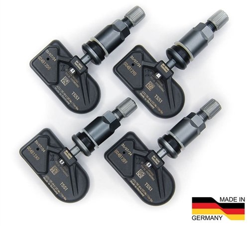

So I found these. There are some cheaper and some a lot more expensive. Any reason not to go with metal instead of rubber besides price?
I just replaced one with one with the metal collar (similar to the one pictured). It is much more noticeable in the black stock wheel. If I were to do it again, I'd one that is just a black rubber stem.
I was going to go with the gray because the rims I’m getting are gunmetal. Is your only regret because of the color?
yes. but if they match your rims, it should be a non-issue.
