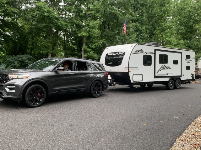

I have a 2020 ST and pull a 27’ travel trailer (23’ box) with a dual axle weighing 4,200 lbs dry with a weight distribution hitch and electronic trailer brake controller. We’ve taken it on 5 camping trips this year, 2 of which were 1000 mi round trips in tow. These 2 trips took us through the mountains (Smoky’s and Pisgah Nat Parks).
It pulls very well for its size but like someone said earlier that it’s not the pulling but the stopping which is most important. I had one white knuckle experience going down a mountain highway when a driver in front of me decided to stop when I was building speed on wet pavement. I didn’t hit anything but I did lose traction. More than anything it was a learning experience. The tow mode works really well, especially on hills. Once you plug in the 7pin it pops up on the screen that a trailer is connected and asks for the length so that the blind spot warning is extended (based on the total length of the trailer and truck) as well as disabling cross traffic when backing up. Depending on terrain I average between 9-11 mpg’s assuming approx 4,800-5.000 lbs w supplies and empty (white, gray and black) holding tanks.

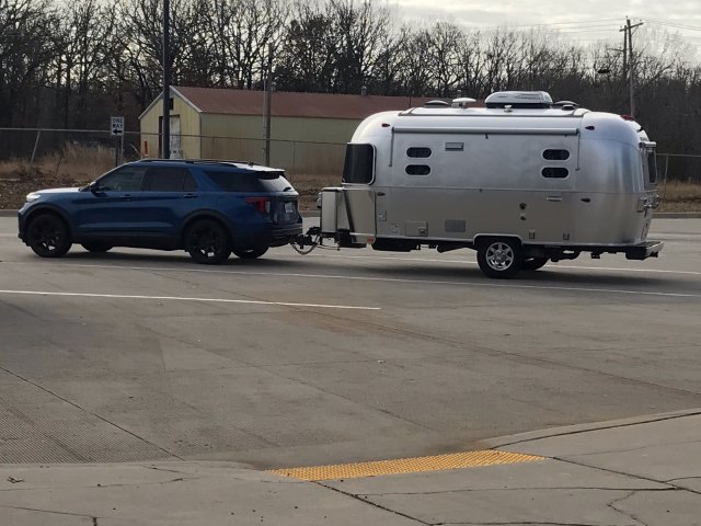

Adding to this thread and confirming that we have a great vehicle for towing. This is our new to us 19' Airstream, we drove it home from Texas to Virginia over about 1,300 miles and over the NC mountains, it towed beautifully and I hardly felt it back there.
Ddrummer
Frederick, MD, USA
#32
View attachment 16150 View attachment 16151
Great set up! It’s amazing what this 3 ltr turbo can do.
