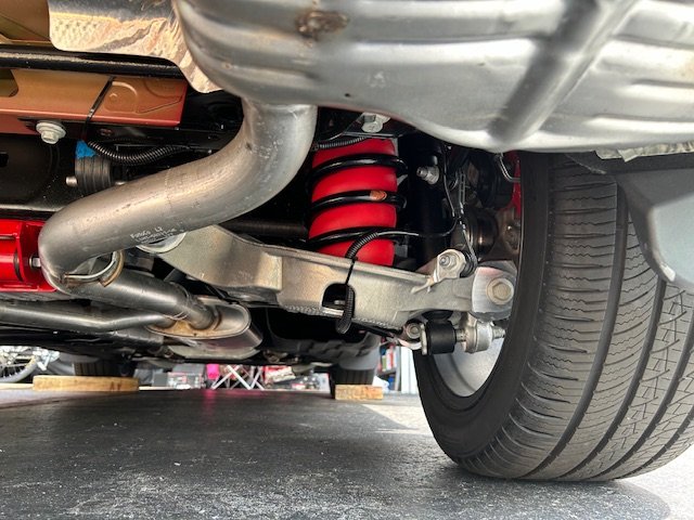

I've towed my fully loaded 16' ATV trailer many times with my 22' ST and now with my 25' ST from Michigan to West Virginia and back and forth from southern Michigan to northern Michigan to ATV ride. I'm at, or just under, the GVWR of both the trailer and my ST on the big trips. The fully loaded trailer is right around 5,000 pounds. No issues with the ST pulling everything even in the steep mountain roads of West Virginia. I do turn off the tow mode in the mountains to stop the engine braking. The engine braking is useless with all the trailer weight pushing the vehicle. It over rev's the engine with no noticeable engine braking at all.
I have Air-lift brand rear coil spring helper bags that eliminate squatting of the rear of the ST and keeps everything level. It also keeps handling where it should be.
