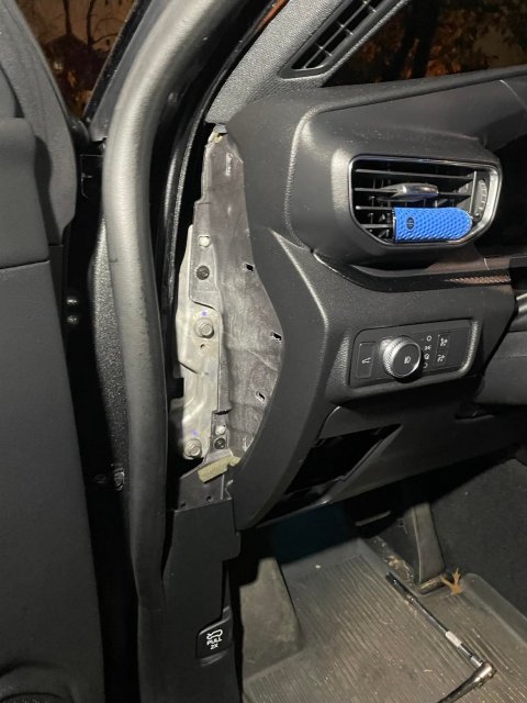

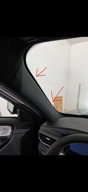

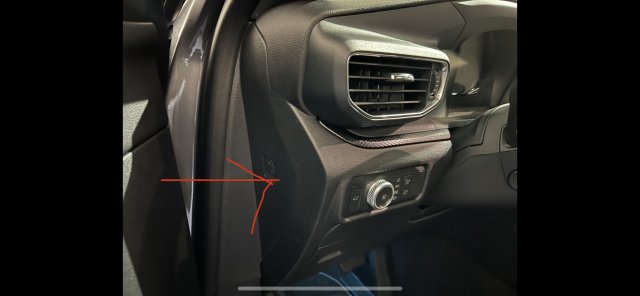

So question about running the wire. So in the second picture, is that where you ran your wire? Space right between the window and a pillar? There does seem to be enough space to tuck the wire.
Then the first picture, the arrow closest to the window, there seems to be space to tuck the wire. It’s where I put the red arrow below the air vent that I don’t think there’s enough room to tuck the wire. What did you do for that?
And then lastly like the OP did, you just removed that side panel with the airbag symbol on it right?

Your arrows are correct that's where I ran it and yes the "end cap" on the dash where the AirBag symbol is was the spot I went into the under dash area.
One of your pics shows arrows pointing to the gap at the base of the A pillar trim, I DID NOT use that path.
I went from RVM area at center of windshield along the lip of the headliner to the A pillar trim, around the A pillar trim (top) to the door opening trim. Pulled out that rubber trim and down the gap until you get to the split between the lower kick panel and the end cap your showing. I went into the under dash through there and into my OBDII connector.
Exact same install on another 2021 Escape
Ran the rear camera wire exact same way up to the B pillar then along drivers side B pillar molding and door opening rubber trim. Then at liftgate I pulled lift gate opening trim off and fished through the corrugated rubber tubing (boot) that Ford uses to protect the liftgate wiring.
Pro Tip: I used a large zap strap as my fish tape to get through the OEM Rubber tubing (boot), after 10 minutes of no success I sprayed the zap strap with a little silicone and it slid right through the corrugated boot. Then you pop off the hard trim piece on the liftgate interior above the window. I put a strain relief anchor on the wire and pulled through an extra foot of wire but thats for those of us with OCD problems, it's not needed. I found only way to aim rear camera was to get image on my phone then crawl in back area and have someone close liftgate. Again I have an OCD problem not everyone will do that.

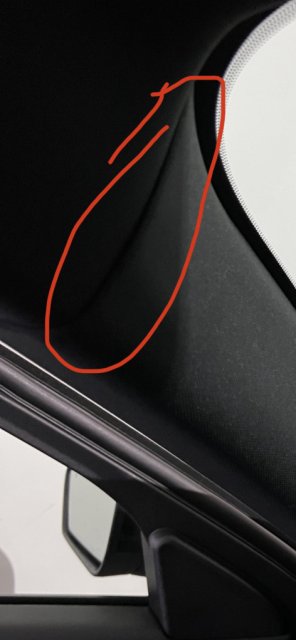

No, that’s very helpful! Did you just use a car trim pry tool to sneak the wire into the gap at the top of the a pillar? Circled area in my picture. That area is very tight and no way I could push the wire into it. I really don’t want to remove that piece. Just hate removing panels.

I used the plastic pry tool to pull A Pillar trim back 1/4" then used another pry tool to push wire down in there exactly
