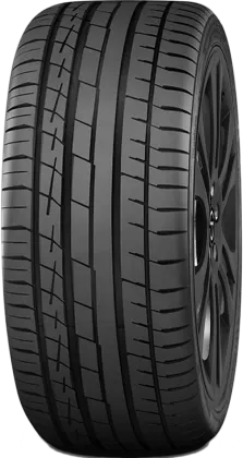

I have 41k on the original Pirelli's. The front has much more tread than the rear.
I am replacing the rears with the Accelera Iota 68 tires. I've seen good reviews for a budget tire.
