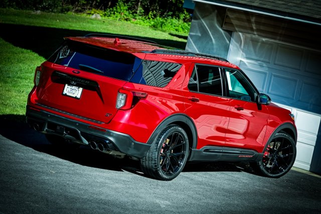

I miss the grip and road hugging stability of the 305/35/22 setup. Can't wait for spring! IMG_5444-cr-v-- (Large).jpg
