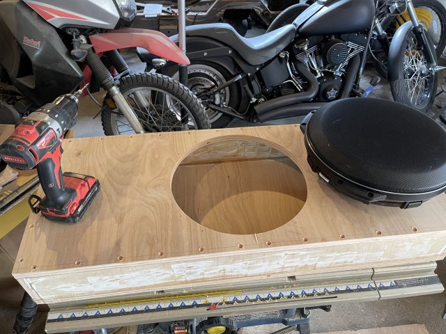

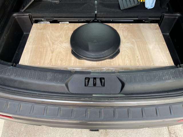

Thread Starter #13
Started the box build. External dimensions are 5”x36”x15”. Fits pretty damn good. I plan on somehow cutting a circle in the factory false floor/rear deck but leaving the carpet which should allow the sub to sit nearly flush with the floor/rear deck. I may decide to something different very soon. I like the idea of being able to completely conceal it and still have full use of the space if needed.
802AFF5F-67BC-44D9-B4A4-464518836FB9.jpeg 7FC32B32-B430-4F5C-A2E4-9DC52958A9F4.jpeg 9E3B43A2-B801-4BDD-A183-998FEABFF298.jpeg
Chaseg08
Chaseg08
89
58
Golden, CO, USA
Thread Starter #14
Spare is still there, if it wasn't obvious. Need to make ANOTHER trip to Lowes before I can mount the sub. I grabbed 1/4-20 machine screws and t-nuts but those are just slightly too big. Box is birch ply.
Storm is rolling in and I live way up in the mountains so I probably won't make any more progress this weekend. Have all my wiring ready to go but as you can see, my garage is full of motorcycles, a truck chassis and a bunch of tools so I have nowhere to work when the weather turns to shit.

Looks good so far! I may end up with my sub there but first I'm going to try and make a custom enclosure where the oem sub goes. Only need .8cuft and it looks like there is lots of room there.
5,453
6,543
Nothing better than glued and screwed Baltic Birch for an enclosure. I’m anti-mdf.
5,453
6,543
Look at my build thread…there’s pics in there of my false floor cover…I think it’s better to build a new 1-piece cover than reuse the oem parts. Super easy to do.
There's a lot of room behind that panel, for sure. This JL 13TW5 only needs .8 cuft and I'm right at that including the sub displacement.
That's what I'm shooting for. I had a bag of packing peanuts appropriating .8cuft. Looks like it should fit easily. There is a ton of space to the rear and under the oem sub so if I need the space i can expand into that area. Don't think I will need to though.
