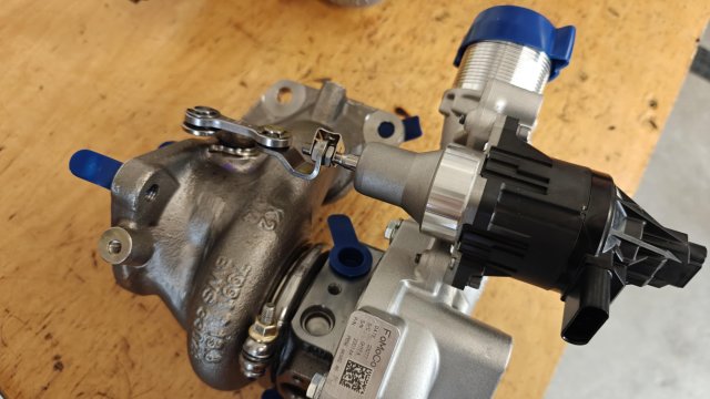

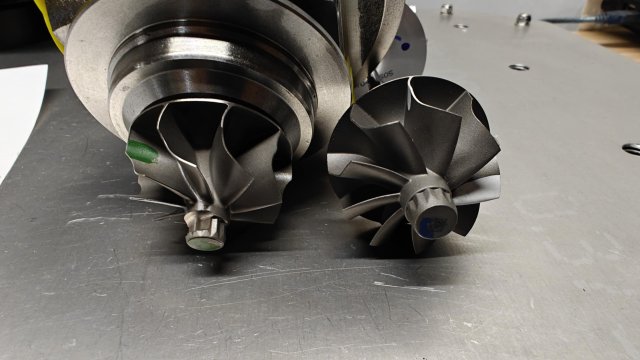

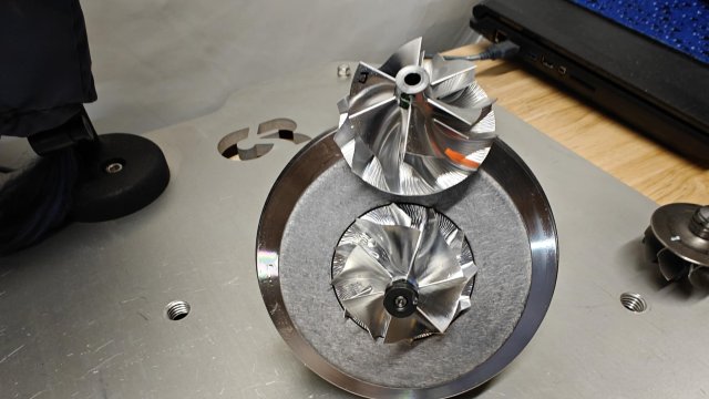

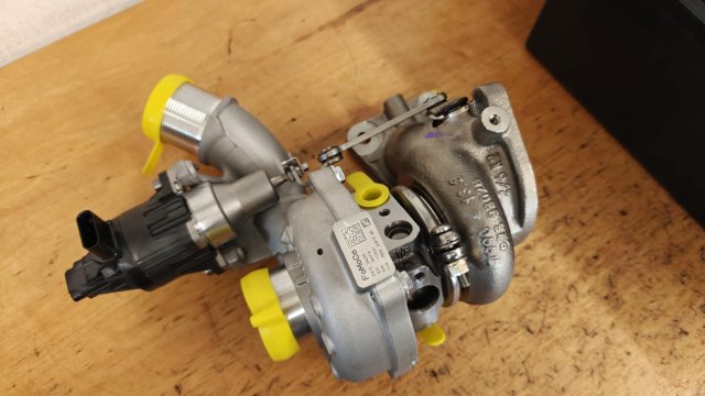

Once we got Andrew’s 2025 ST on the dyno, I knew something was up. We made solid numbers, but the top-end power wasn’t where I expected it to be, even though the logs looked promising. So I had Andrew at CR Performance Engineering crack open a set of the new turbos ahead of his scheduled R&D—and sure enough, Ford downsized them.

Yes, the 2025 turbos are physically smaller—but that doesn’t automatically make them worse. These are clearly the next generation of BorgWarner aero, and the data supports that. They spool faster and hit harder down low. But on the top end, that smaller turbine seems to choke off exhaust flow. You hit a point where “more boost” just doesn’t equal more power.
