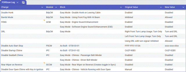

FORScan
I have attached the changes I have compiled from various sources. I love all these changes with disabling auto start/stop being my fav. It does come with a minor side effect of sometimes displaying "rear brake assist not enabled" or something similar, but this only appears for a few seconds when shifting into reverse. If you depend on rear brake assist functioning I do not recommend. There is also a hardware option from AutoStop Eliminator that many seem to have used with success.
This is a good thread and where many of these came from:
https://www.explorerst.org/threads/r2d2s-2022-st-kiss-build.5210/

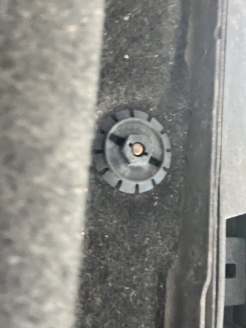

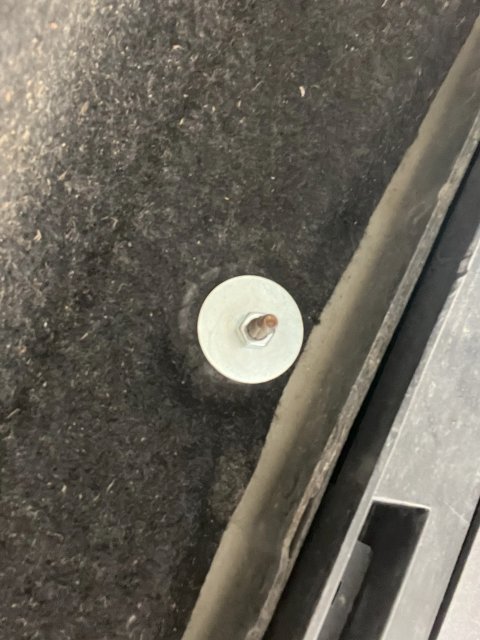

Underbody Felt Aero/Soundproofing Problems
I was experiencing rattling sounds which seemed to be coming from mid-door height on both sides of the ST while at highway speeds. The sound wasn't substantial, but more like paper or a light wire flapping and scratching against something in the wind. On the drivers side it sounded like it was almost in the keypad area, but nothing was loose on the ST that I could see. After researching, it is a well documented issue with the felt underbody aero/sound baffling which is secured to threaded bolts on the body using crappy plastic retainers. These plastic retainers seemingly fail or do not do well after being removed/reinstalled during maintenance. When I got underneath the ST I found a few that were clearly moving up/down when pressed (including the one directly below drivers side door).
The fix is remarkably simple using 1/4 in. x 1-1/4 in. stainless steel fender washers along with M6 nuts (zinc or galvanized may work fine depending on environment). You should be able to replace without jacking up the car, but I found it helpful to put mine on ramps and using a creeper so I could check them all (cheap from Harbor Freight). I had to pretty much cut the original plastic retainers off but I am sure there may be a more graceful way to get this part done. This issue was driving me absolutely crazy... problem solved!!!
Before/After Pics
(Clearly shows how the plastic retainer has slid all the way down the threaded bolt - new one screwed up tight)
