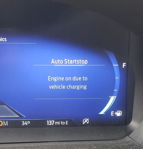

Well after having the Battery-Minder on for a day and half I removed to check some things. Here is what I found.
Battery Voltage 12.95V A little high
Vehicle running Voltage 15V Again a bit high
After driving for about 45 minutes still A/S not working.
But here the message I get. Engine on due to vehicle charging.
After stopping checked voltage again.
Vehicle running. 15V still a bit high.
Vehicle off 12.2 Dropped .75 Volt.
So looking at how much the voltage dropped after driving my first guess is the battery is on the way out.
Plan to call my service advisor to see what he says.
Hoping he agrees as I'm down to 2 months of 3/36 warranty.

Yeah that’s the exact message I get. Is that actually much of a drop? It’s still over 12v. But it may be the issue. I mean I’m glad the system is acting in a conservative way and not running when it shouldn’t be. Pending actually how much more life I have of my battery, I’m good with where it is. No start stop system but everything running.
let us know what they say.
