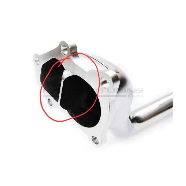

Just out of curiosity, could you show a comparison pic with a "sewer pipe" vs a properly designed exhaust, for the same car/engine? What would such a diffuser look like?
Or is it as simple as the divider i circled in the pic?
1,508
No, that is a splitter or divider. A diffuser is a conical section (think ice cream cone being fed from the bottom) that extends from the turbine exit. For example, if the turbine outlet is 3", a diffuser would be a transition from 3" (turbine exit diameter) to say 5" (cat entry diameter) over a 6" or so length. Then a sharp 90 degree bend into the catalytic converter. From the cat, it would neck down to a 3" single exhaust. I designed a single turbo system for a forum member that used those exact dimensions. Because the exhaust exits the turbine tangentially (swirling or helix- direction depends on whether the turbine is speeding up or slowing down), the gradual change in diameter causes the velocity to be lowered and the pressure to be raised along with lessening of the angle of the helix. The sharp transition to 90 degrees directs the slower exhaust gasses back into a laminar flow as they enter the cat. I understand that this 90 degree transition seems counter-intuitive, but that's because we are not dealing with laminar flow out of the turbine.
That is the ideal way to engineer an exhaust post-turbine.
Without this mechanism, the swirling exhaust gasses are need to "screw" their way into the catalytic converter cells which increases backpressure. The cat itself will end up returning the flow to laminar- but the least backpressure occurs when the flow is laminar PRIOR to the cat.

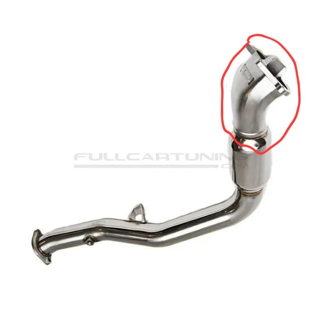

Ok, so its kind of like the part i circled here? (Not completely the right dimensions/shape without the 6" section to taper it down before the cat but i guess its the same idea?)
Dont think i've ever seen one, in the way you've described it.
Would it be improved further if rifling/spiral grooves were used in the section before the cat? To help shape the airflow? (If i understood it correctly, before the cat the air is moving in circles and after the cat it basically is straightened out?)
1,508
You have it backward- perhaps you are not understanding. The taper is from a smaller diameter to a larger diameter.
And no, the exhaust post-turbine does not need any sort of "rifling".
The exhaust you picture seems to be one that divorces the wastegate exit from the turbine exit. A completely different animal.
Ah yeah, read it a couple of times but now again and realized indeed i had the 1st step backwards.
If you know of a product that is setup as you described, id love a link/pic to see it.
Thanks for the explanations!
