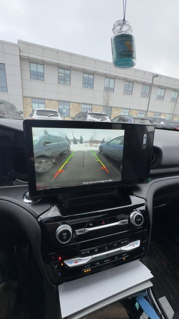

So my order finally was delivered and install was no issue until mounting the 13.2” but the air vents coming from the 10” screen are not wide enough with the bracket so I took that off for now. Got everything hooked up.
Issues im facing is siriusXM is not loading but nav is working and the vehicle does show active satellite data going through the testsettings.
can’t control rear HVAC on the screen and I had it locked before the swap so those are stuck on high heat full fan.
Bluetooth shows up as F250 if that matters.
Apim needs programming. Get with Jesse infomation
You need the APIM program. The Sirius XM will work but the wrong code is in the APIM.

Tried accessing the APIM and it won’t load on FORScan under a new profile. Try to use a saved profile and it doesn’t detect the module and errors out. I pulled battery cable last night until this morning and it’s still not showing.

after being able to have time to look through things I was able to get it to speak with the sync4 APIM.
Still having issues with SiriusXM, sometimes it works, most off the time it just says loading.
Navigation both native and through CarPlay gets lost, noticed the compass also doesn’t work accurately, (will say south when heading north, east instead of south). With that “intelligent” cruise control is intermittent but will work once or twice randomly.
can’t pull up rear-climate controls and before the swap I had the rear controls locked out to prevent the little from messing with them and now I can’t change it.
Visually, when changing temp or volume the circle pops up but doesn’t show any changes or current values.
The APIM seems to have listed any and all options that could be made in any vehicle which is so helpful…. it’s also pulling an error saying communication fault with the telematic unit to be expected.

The factory hvac controls work as normal when they are plugged in.
when they are not plugged in the hvac controls on the screen do not work at all, the temperature reading is disabled so is the start stop system and the auto hold function
I’m thinking some as built stuff would need to be changed. Just a matter of what
They shipped me a new HVAC control unit that is slimer and plugs into the factory connections with no controls. I can tuck it away behind the screen.
Im still stuck with the following issues;
  • HVAC fan speed is only controlled by the AUTO button and not by the knob on the screen.
  • Rear HVAC controls are non-functioning.
  • Volume is displayed at zero no matter what volume it is set to.
  • Fordpass is not working
I have a feeling it's something to program in Forscan, possibly? I just gotta figure out what.
Yes it's all in the programming

Here is the APIM. It appears that the VIN is 5LMJJ3NT4NEL07017
You need to source a F150 apim. I'm doing a lot of research and everything detail is pointing to the f150 apim to program.

I talked with Jesse-Infotainment, He will sell you an programmed APIM for the screen. Buy price is about $600.

I talked with Jesse-Infotainment, He will sell you a programmed APIM for the screen. Buy price is about $600.
Will everything work? Even FordPass?
Stone17
485
313
Thread Starter #78
Yes. Everything works.
I can't adjust the steering wheel feedback when crossing lanes but it doesn't bothering me.

Ford Pass work directly after the swap. If you want to remove your phone and re-add it you have to install the Sync 3 back in.
Here a video with the new APIM with navigation.
