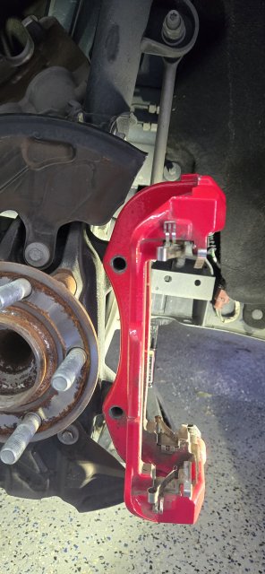

Only installed the Front right now. You will need the brake line that match the bigger brakes.
You will need to trim the brake shield. I used my Aviation Snips to cut the shield.
Before
After
